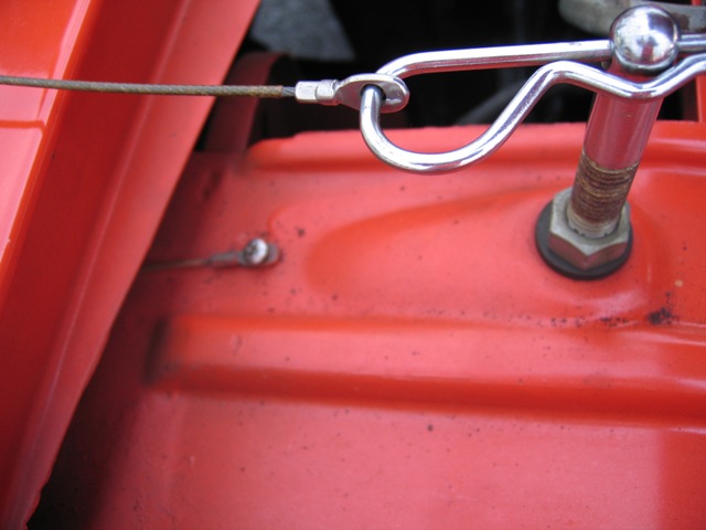

For cable mounting (and correct hood pin hardware), here's a pic from a survivor.

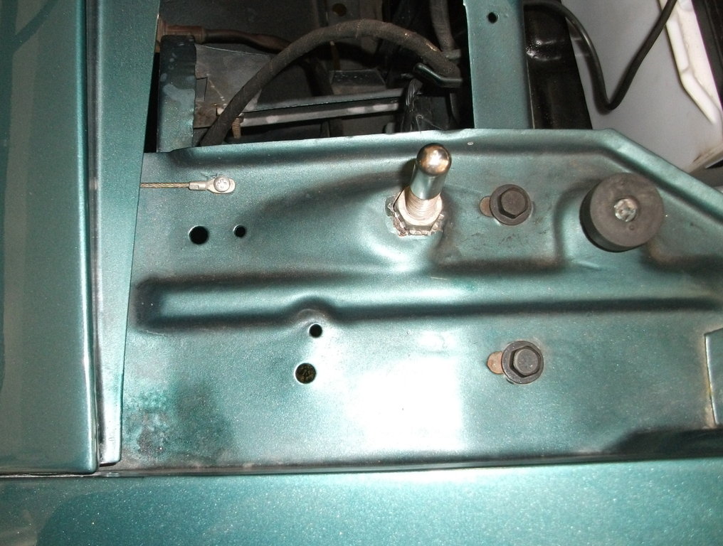

Thanks for the picture.
Look at the rad support to fender piece on my car. It seems they changed the part or started stamping holes, and there's no indent on that raised ridge. Mines the same as Bruce's '72, yet its a '71

The additional holes (two 5/16" bolt holes with a smaller locating tab hole, each side) in the fender support are related to the relocation of the horns forward of the core support in 72'. Appears you may have 72' fenders, close look at the metal work around the side marker lights, may prove a conversion at some point. One of my 72' donor cars had one 71' fender on it without the additional holes and a filled in 71' side marker mounting.
As for the lanyards, the 3579673 26" part number above, the 72' parts books has it as an e-body part and an 18" lanyard listed for the b-bodies. This picture of a possible original 72' car may support the lanyard not routed out around the bumper but up between panels.

Mine has the extra holes,both original 71 fenders.NOrrTH wrote:Thanks for the picture.

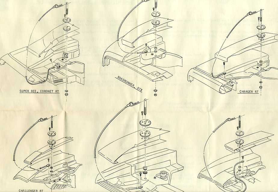

Looking at that picture of the blue car just above, I see its got an upright pin clip whereas the NOS pins and 26" lanyards are flat. I wonder if there were two styles of clips for E and B body cars? Also, if 18" lanyards are correct for B bodys, the only way they could possibly fit is between the hood and header panel.
These two pictures from Chrysler would seem to indicate that is, in fact, the case. Thats a 'Cuda below the Charger R/T and a Swinger 340 below the Roadrunner. It seems that only the Superbee/Coronet R/T and the 'Cuda had the lanyards routed through the grille.
Regarding my fenders being '72 on a '71; I'll have another look at it when I get home, but off the top of my head, I dont recall seeing any metal work on the inside of the fender around the side marker lights, which are inset.
That said, Chrysler's picture of the mounting location doesnt resemble a 71 or 72 so who the hell knows.

I would suspect the Road Runner / GTX in the diagram is a 70, as the hood does not extend to the bumper on 71/72 cars.
Re: Hood pin cables
ahh your right, thats why I dont recognize the cowl support, I thought it was a 71/72 with the bumper off.
