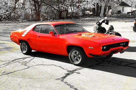

- big message post signatchahhh.JPG (36.88 KiB) Viewed 35155 times

Nice ride and welcome to the nest! I think 3.23s would be the next step up - still good gas mileage but a little better take off. The 3.55s I think would be a good compromise between mileage and acceleration. You running the standard 8 3/4?
