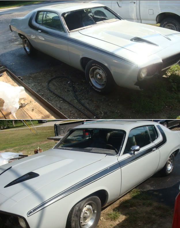

It had to been one of the most interesting Thanksgivings ever. While a friend of a friend was checking out my '73 Road Runner, we discovered it possibly had a sunroof. Unfortunately, the broadcast sheet with the car is from a black on black Road Runner with a VIN # that is one digit off from mine, and the fender tag doesn't seem to indicate it... HOWEVER, I always wondered why my roof color was slightly off-color from the rest of the car and had cracks in it and somewhat of a flatness to it. I always just assumed someone had sat on the roof during a drive-in movie back in the '70s. Turns out, the roof area from the stripe forward is all bondo using the magnet method and gets very flat where a sunroof would be. Furthermore, running my hand underneath the obviously replaced headliner (it's in great condition) revealed what felt like a full sunroof lurking under there, sans glass perhaps? I am going to pull the headliner tomorrow. Unfortunately, the code for a sunroof is NOT on the fender tag, and with the wrong broadcast sheet, I'll just have to inspect it to see if it looks factory and if so, I want to return it to a sunroof car. It was probably leaking or broken so I'm guessing the previous owner simply bondo'd over it to give it a hardtop. Silly, silly.
Also, did all sunroof cars have vinyl tops? Mine currently does not have a vinyl top. On the fender tag, it has two JF1-code stampings which apparently decode as: "Pale Green Exterior Color" and "Pale Green Top Color". Does this mean it had a pale green vinyl top originally, or does that just mean it didn't have a vinyl top?

Already been there, but noticed the description for that area (which reads "JF1" on my tag) says "UPPER BODY COLOR OR VINYL ROOF CODES". I guess since "JF1" is a paint color (Pale Mint Green), I will presume it means the roof was simply painted JF1 like the rest of the car and it never wore a vinyl top.

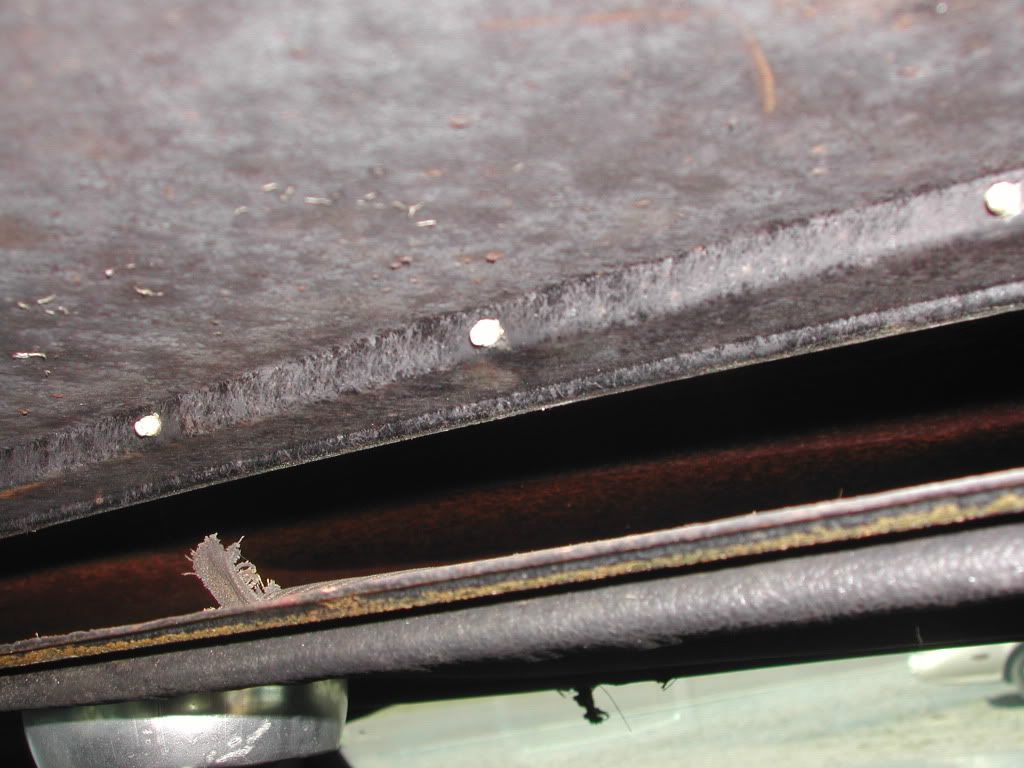

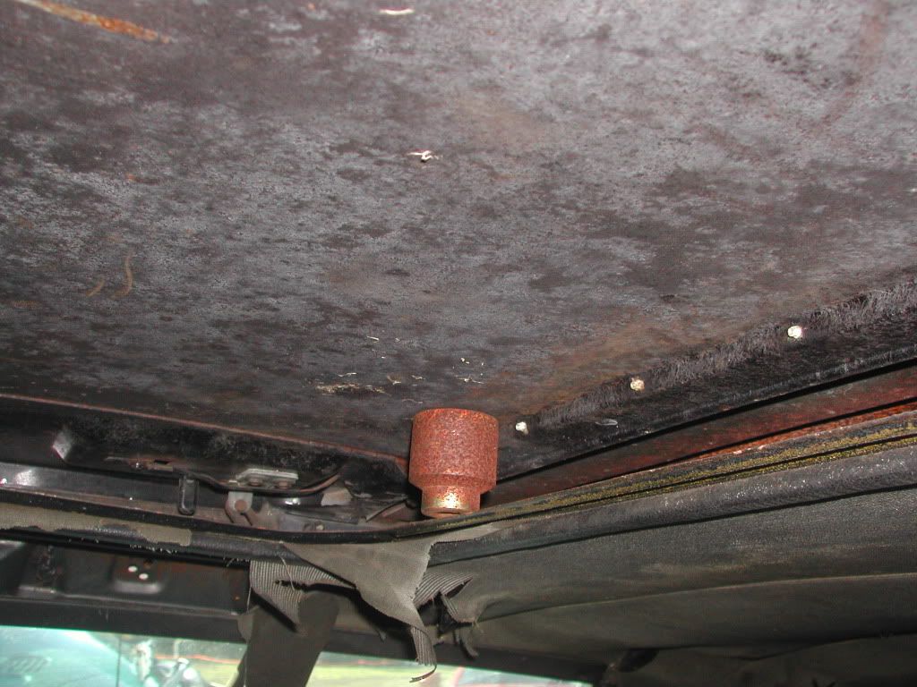

Peeled the headliner down a little bit and examination revealed a very thin, rectangular metal panel (complete with faux wood) welded over the bottom of what could have once been a sunroof. The top part of the roof is all painted-over-Bondo. Sigh. It's never easy, is it? If I wanted to convert it back, presuming it even had a sunroof, either factory or otherwise, I would need EVERYTHING and probably some professional installation. But I want the sunroof back!

I'm gonna hate myself in the morning: took a big drill to where the suspect area was and and it's about a 1/8" of putty in which the entire sunroof area was sculpted from to form a roof. No metal was used, except a very thin panel tack welded to the underside of the roof beneath the headliner (I'm guessing to support the bondo). Guess I need to either fix it right and find an entire sunroof assembly, or fix it right and get a section of roof to have welded in. Damn, people do weird things to cars, and I think I just made it worse. :oops:

Still have not found any evidence of drain tubes, so I'm beginning to wonder what the deal is. Some say they ran along the A-pillars, some say the C-pillars; however, if they're just rubber, they could have been ditched when he reinstalled the interior. Seems pretty mickey mouse; the usual short-cuts, mismatched screws, etc. Any way to tell for sure, such as by examining the under-roof bracing, et al, if it had a factory sunroof? Also, anyone have any close-ups, interior or exterior, of the various types of sunroofs (manual, powered, etc.)?
