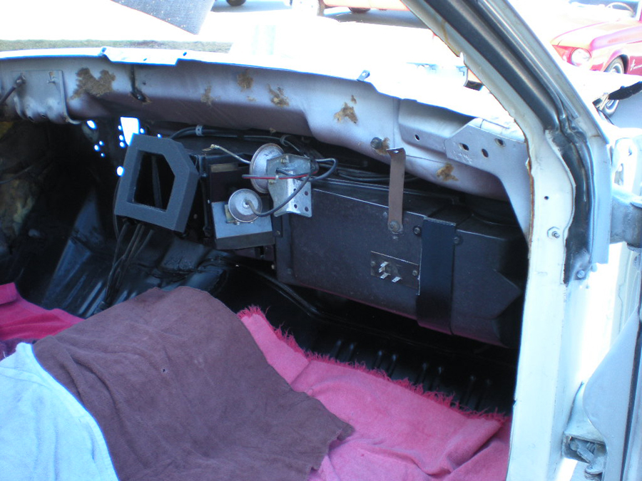

dang...ya'll beat me to it. DMT's foam kit is great! I even found and documented a piece he didn't include, but would in future kits.

Post by steved » Thu Sep 16, 2010 10:33 pm
there was a thin foam strip at the top of the AC core in mine. you could see where the tape mark was from the original.
there was also a foam pad on the back side of one of the flapper doors, to keep it from "clanking" when opening.

Oh, I remember that. Yeah, got those installed. Just wondering
