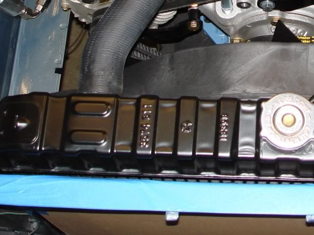

I searched and could not find it. Can someone please tell me the part numbers for 1972 big block radiator 26 inch with or without A/C. Thanks.

For 72’ there were 3 26” tank numbers listed for the b-body 3574611, 3574612, and 3574613. All serviced by only one replacement part# 3574611.

72RoadRunnerGTX wrote:For 72’ there were 3 26” tank numbers listed for the b-body 3574611, 3574612, and 3574613. All serviced by only one replacement part# 3574611.
Thanks!
