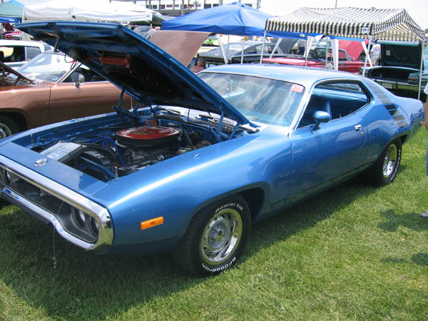

Every original big block car (including Satellites) I've seen had them....including a first day built road runner....so it wasn't an early vs late build thing. I do know of one survivor 318 Satellite that doesn't have them, but they could have been removed. Not sure if all small block cars had them or not.
Here's a pic of an A/G car with them.....obviously restored, not a survivor though
