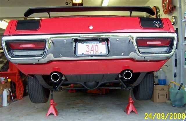

I did not use slotted tips, Instead I used a very good quality tip that I liked and I cut the valance to match the tips......Not as original, But I think it came out nice....Here are a few pictures.....

Re: 71 RR rear valance
Post by mopar71 » Tue Oct 14, 2008 10:01 pm
Wow!, Nice Job, :beer:

My rear panel was already cut for square tips (like the dart uses) I cut them round to match the tips I liked...Besides, it's not only the $250 I saved, I did not have to remove, re-install or repaint my valance...I cut it out rounded on the car and put a slight flange on the cut without having to paint it....It took a total of about an hour and a half to do it and I think it looks great...
You saved more then $250, the tips (slotted cost around $225), Don't forget about the cost of paint and the labor or your time to install it and shoot it. I think it looks good, and I like the fact that you can do it while it's on the car.
