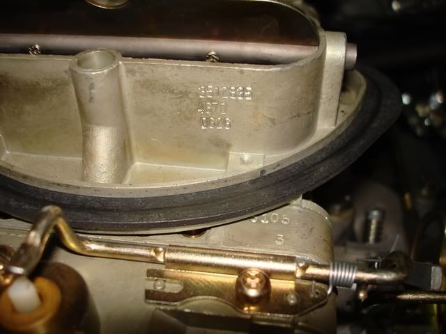

For a while now I've ponder the idea of a six barrel setup for my 440 engine, and right now I'm researching the oe casting numbers for 71 center and outboard Holleys. What are those numbers?
I believe I have the outboard carb's number at 3462373? Is this correct? I've also seen the letters MTX associated with the 71 carbs? What does that mean?

Carb numbers...depends if it's an auto or 4spd. Part #s:
auto center - R4670
4spd center - R4669
front - R4671
rear - R4672

When I was looking for carbs for my RR, I learned that Holley does not make the 71 castings any longer. Apparently they used to but stopped a little over a year ago. I do see them on Ebay once in a while from distributors who have some in inventory. Now someone told me, and please verify for yourself, that the new ones Holley makes is actually based on the 71 carb but has the 70 cast numbers on them. Again I have not verified this. Something to do with the bowl vent I think.

The carbs I have came from MP under the numbers P4349237 (center) and P4349238 (outboards). Checking today they are still being offered on the website. Summit racing has them under the number DCC-4349237 and DCC-4349238. It is my understanding that these are new Holley reissues of the original carbs. One easy way to tell the difference between NOS or original carbs and more current reissues is the presence of hex headed bowl screws. Original/older Holley’s would have slot headed bowl screws. I will have to double check, but I do believe they are stamped with the correct 71†list numbers.

It's all pretty confusing. I checked out Summit Racing, and they list different o.e. casting numbers for the 1971 holley carbs that Eric listed above, in addition, they only list the center carb for a manual transmission, however, they offer the outboard carbs for either a manual or automatic.

IMO,
There was a time many years ago, when others my age would have been studying for college, I spent countless hours thumbing through 3 inch thick Holley parts catalogs trying to determine the variances in different Holley list numbered carbs. Here’s a bit of what I learned. First Holley carb numbers were stamped (not cast) into the main body of the carb, and are referred to as “list†numbers. A Holley carb is biased on the numbered series of similar design; six-pack carbs are of the 2300 series Holleys. Holley six-pack O.E. list numbers represent a specific designed configuration of the 2300 for a narrow application. Back then all O.E. carb tuning was performed by Holley at manufacture. Idle mixtures were set using flow meters and in the case of the outboards, mixture screws were then sealed with lead plugs. The center carbs were set up the same way and then had a limiting cap fitted to mixture screws to prevent adjustment in the field. The metering plates on the outboards were not the same from front to rear (slightly different main jetting), different list numbers. Automatic trans cars (ATX) would have had a slightly different idle mixture than a Manual trans car (MTX) and would have a list number for each appication. This insured that they could bolt them on at the factory without fussing with tuning and prevented easy tampering buy owners and others. As long as there were no changes to the stock engine configuration and it remained in perfect tune there shouldn’t be a need to adjust the carbs. This also meant that during the one year warranty period, techs in the dealer network could replace a faulty carb with a corresponding list numbered carb pretty much bolt off—bolt on, again not wanting to payout for any tuning time. Yearly changes to the carbs meant a new set of list numbers.
So, of course every Holley O.E. list number has to have a corresponding Chrysler part number. You can find tables for them most anywhere. When a Chrysler part becomes obsolete or is no longer serviced by Chrysler the part number is referred to as NS1. Back then the only way to get these carbs new was through a dealer using a Chrysler part number, now long since NS1. Holley never sold O.E. list numbered carbs directly in the past.
Jump ahead to present day, with resurgence of the muscle car restoration hobby the last decade or so, Holley has reissued some of the six-pack list numbers. Basically a set of carbs for the small block and a set for the big block application. The big block carbs are updated versions of the 71’ R4670 (center) and R4672 (both outboards). These carbs have new Chrysler “P†part numbers and can be purchased from MP or indirectly from third party sources. Holley's web site currently offers reissue carbs with what appear to be 70’ list numbers (4144 & 4365 outboard). I recall that MP used to offer a big block 69-70’ set along with the 71’ carbs. I wonder if maybe MP and Holley spilt up the marketing of these carb sets. One of the few changes Holley has made to most their carbs was moving to a hex headed bowl screw. As most of us know fuel bowl screw torque is most important on a Holley and the old slotted screws were not easy to torque correctly. You can buy a kit containing the old screws to retrofit a newer carb. Metering block/ Fuel bowl gaskets and power valves are of current design.
BTW, these carbs do not have the idle mixture screws covered or blocked.
