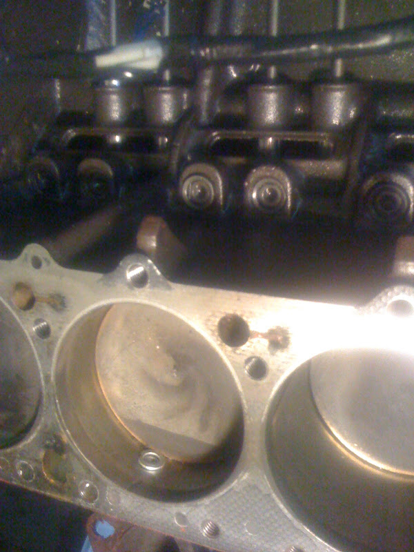

Okay, so I'm removing my valley pan and a small washer somehow drops into one of the intake ports (I think). So far, I've lost a magnet (dropped into the heat cross-over) and am still no where close to finding that damned washer!
I tried using a retractable stick type magnet but it's not picking up anything in the intake ports. I've also tried inserting it into the spark plug hole(s), but it's a little too large in diameter. I then held it at the hole and blew compressed air into the intake ports hoping it would move the washer around enough to stick to the magnet, but no luck. Of course, I didn't try it on the next spark plug hole because I figured this was lame.
I'm seriously thinking of removing the head, but have never done this before. How much of a pain in the ass is this, and I guess I will need a new head gasket at the minimum. I'm seriously thinking of going with 440 Source's Stealth heads while I have it torn apart, but $$$ is always a factor. I just hate removing the head for something so stupid. :rant:

I think taking that engine completely apart to know for a fact that there are no foreign objects in it is better than starting your engine and everything going...well im sure you know what would happen... :o
When i was cleaning around my engine i had stuff on top of it,and with no manifold or distributor,and hunk of pipe my dad cut for spacers when we mounted the engine fell inside the distributer hole,stayed right on the gears,i carefully go it out. :lol:

I wouldn't take a chance, you might as well tear both heads off and get a valve job while your at it. You could even port the heads and gain some performance and not have to spend big bucks on those heads. None of this is too hard to accomplish if you are mechanically inclined. A FSM would be a great help but it could be done with the help of a Haynes or Chilton. On a scale of 1 to 10, I would say this is about a 4 or a 5 in difficultly. It can be done with good basic hand tools. A torque wrench is necessary. Good Luck.

I know that next month I'm getting the 440 Source Stealth heads, so I just want to do a quick R&R of the head in question. Do I need a new head gasket, or are they reusable? Also, do I use any sort of sealant?

Happy 4th, everyone! I removed the right-side head. Please note #6 piston. :roll: Believe me, I checked high and low for that washer all over the frame, ground, engine, etc. before I resorted to magnets, strings, chop sticks, and ultimately, giving in to intuition and facing reality. :shock:
