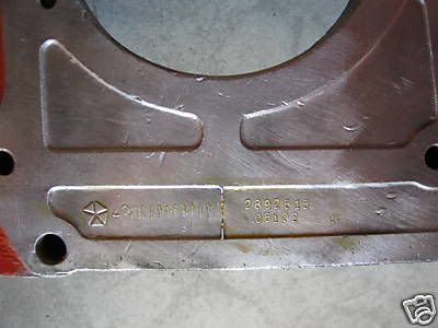

Where on the bellhousing is the casting number stamped? I dont see it anywhere on mine,and I have to get a dust cover but they want to know what casting number you have.

mopar71 wrote:Where on the bellhousing is the casting number stamped? I dont see it anywhere on mine,and I have to get a dust cover but they want to know what casting number you have.
IS ON BACK OF BELL HOUSING PASS SIDE 511 512

that72RoadRunnerGTX wrote:Numbers are cast into the transmission mating surface. I believe the correct number should be 2892513.
that is number

With the transmission in place you won’t be able to see the number. If the bell housing is original to your car it should be the aluminum “513†version. There were older cast iron big block housings used for the 130 tooth (10 ½†clutch) and 143 tooth (11†clutch) flywheels. Each had a slightly different sized inspection cover. By 1970 all big blocks used the same aluminum “513†housing. Year One sells a steel reproduction inspection cover under the number BHC105. I have seen plastic reproductions available too, however not recommended.
