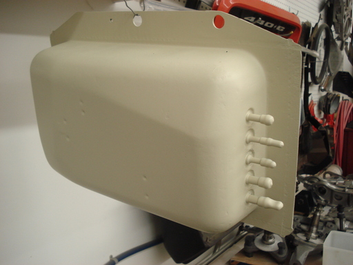

Post by 72RoadRunnerGTX » Thu May 01, 2008 12:58 am
Midyear 72’ and up vapor separator.

72RoadRunnerGTX wrote:Midyear 72’ and up vapor separator.
Much better location than the 71s IMHO
