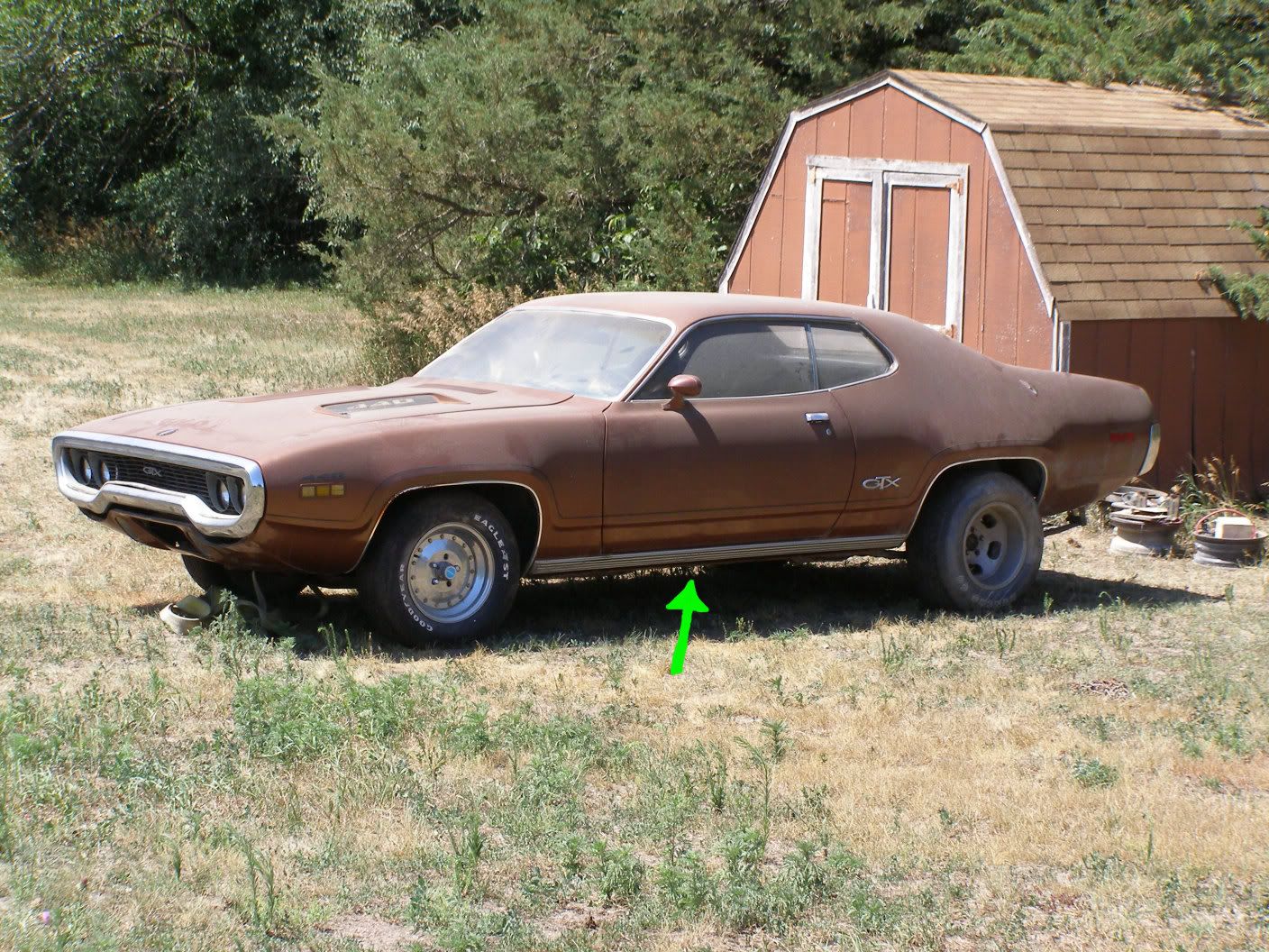

I'm not quite sure but of all the differences the rocker molding is about my favorite.
A 1972 Roadrunner with a 440 (4 bbl or 6 pack...Hemi no longer offered) engine had 3 "GTX" emblems on them.  Not the big one like on the grille of a 1971 GTX but smaller ones.  One on each fender behind the front wheels, the other on the trunk lid.
The "proper" place on the trunk was on the right with the circular standing bird decal. For some reason mine came with the GTX emblem on the left side, which is where I put it when I restored the car.
