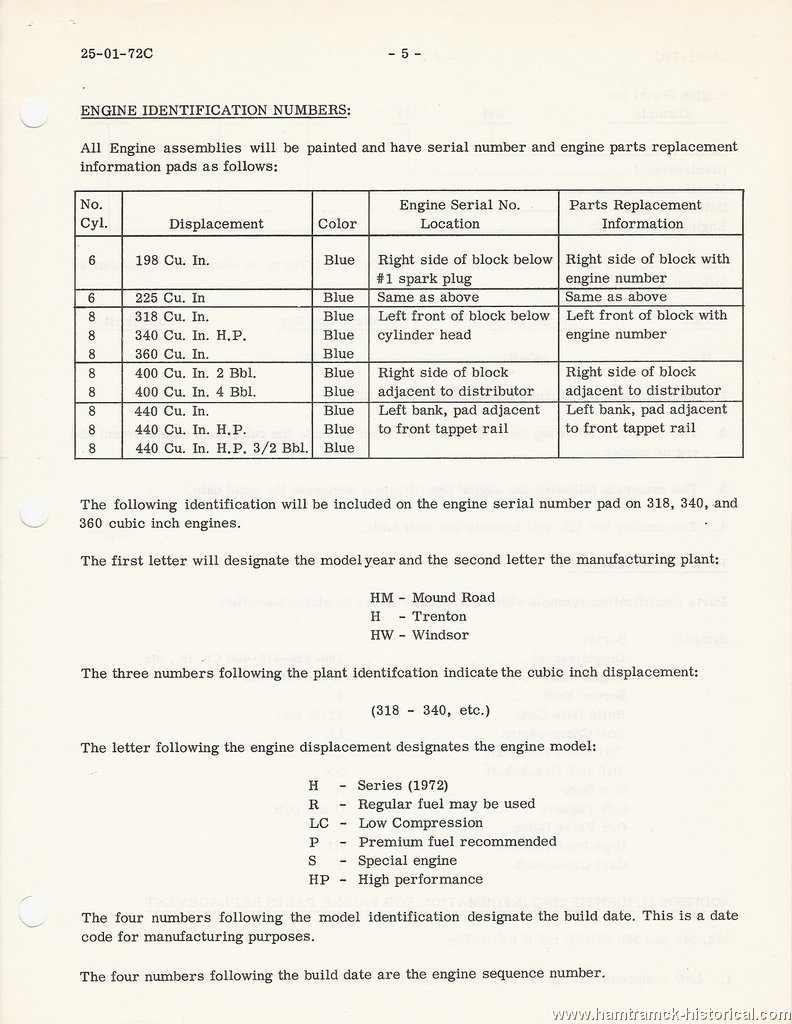

Post by Alaskan_TA » Fri Mar 07, 2008 10:30 pm
A page from one of the 1972 Plymouth TSBs about engine colors;
http://www.hamtramck-historical.com/ima ... page_5.jpg

Post by DeLorean00 » Sat Mar 08, 2008 12:05 am
Thanks for all the help everyone!! I guess blue is it!!
