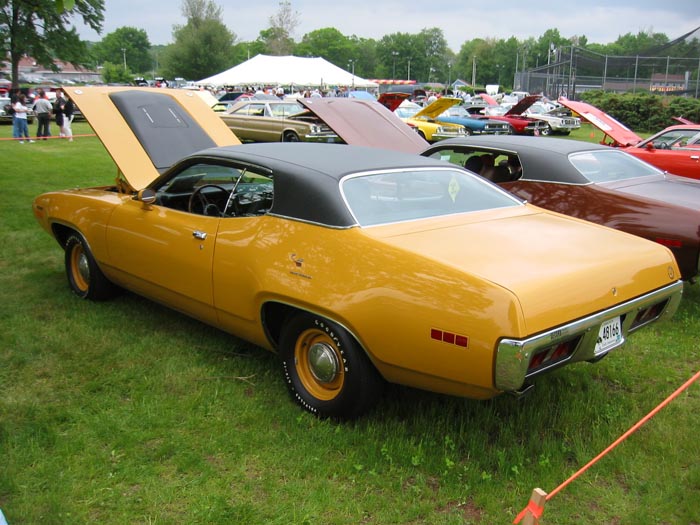

How easy is it to abbreviate or 'truncate' that vinyl top? Mine has a full vinyl top but all the RR's I see either lacked it or had a half-top covering. Or should I just remove the edging and just do without? Is that a major process, removing that?
Post by bruce » Thu Jan 17, 2008 4:17 pm
LOTS of Road Runners had the full vinyl top. GTXs too... I've owned a vinyl top RR myself...
Removing a vinyl top isn't hard, essentially you just peel it off. Of course you'll be left with all the adhesive, bondoed joints, rust and junk that's under the top. Remember, full vinyl top cars got bondo (read moisture retainer) in the seam between the roof panel and quarters (and between the roof and a-pillars too), and didn't get full paint where the top was covering.
Removing HALF a full vinyl top to make a canopy top? That would be harder. You'd have to cut the vinyl where you wanted it to STOP and NOT peel off the front half. I think that would be easier said than done...
Also, you'd need to find the proper trim, clips and mounts for the canopy top trim. Filling the holes left from the full vinyl top trim should be easy too, but best done when you're painting the car.
Honestly if you're going to paint the car, a new vinyl top would be your best bet. Then you can decide whether you want to do the full top, canopy top, or just leave the whole thing OFF. :beer:

Yup, plenty of 71 runners and GTXs got full vinyl tops. One of my personal favorites...

Thats my favorite to, thats what my car will look like when I finish it. A full vinyl top. 8)
