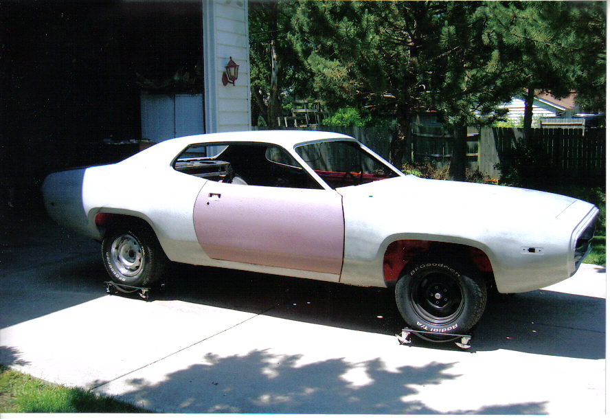

does anyony have the part numbers or know where i can find the clips to hold on the trim.i would like to reinstall the canopy top on my car.here is a pic of my car.

Carman...The clips you need are from Auveco with a part number 11354.
Go to:
www.auveco.com
they have an online catalog and if you download it, the clip is on page 457 of 660. Or you can go to any auto parts store that carries Auveco clips and fasteners and give them the P/N above.

I hoope this helps. I bought mine on line and they are almost dead nuts to the originals
