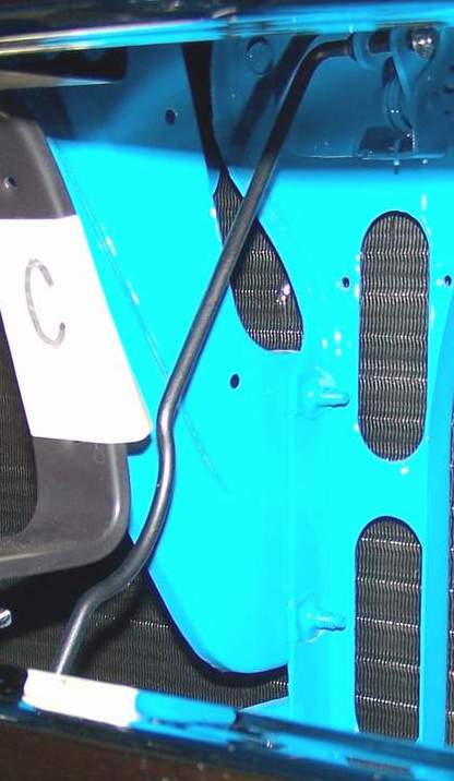

Post by 72Rdrnner » Fri Nov 16, 2007 9:22 pm
Here's a closeup pix of the rod, all except the bottom which is nothing more than a 90 degree bend. It only fits in ONE way as the curve in the middle has to clear the center grille (honeycomb) mount.

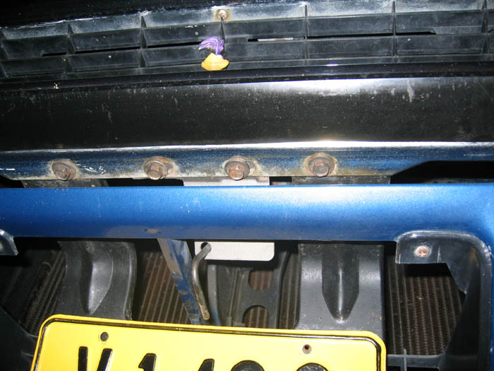

Post by Eric » Sun Nov 18, 2007 6:42 pm
Below the bumper at the opening in the front valance. There should be a bracket bolted to the bumper with a hole in it for the rod.

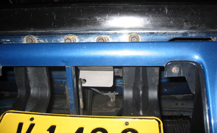

Post by Eric » Sun Nov 18, 2007 6:45 pm
another view
