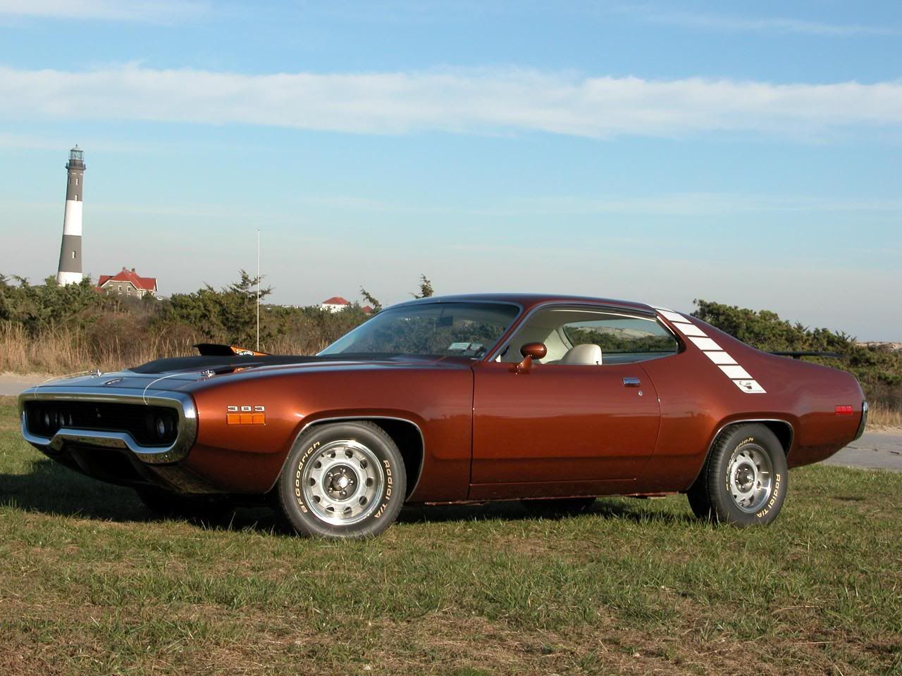

Thanks for the welcome Ctown. I'm the third owner and have had the car since '86 or so. A 10 year resto was completed by me ( with the exception of exterior paint) in '02. I used as many NOS parts as possible, which took a long time to acquire, not to mention the cost. It only made it to Carlisle once in '03 I believe. It's a numbers matching 383/727 ( I added the A/G ) Autumn Bronze Metallic over white car. I replaced the 3:23 rear gears with a set of 4:10's and bumped the compression a bit and added a purple shaft cam. A 750 double pumper sits atop a Edelbroke Torquer manifold. Hooker Super Comps expell the exhaust through a 2.5 in aluminized system with crossover pipe and Flowmasters. Exhaust system is topped off by a set of repro slotted tips. Tranny ratios remain stock, with B&M Transkit, and 3000 RPM converter. Interior is all stock appearing with new everything. I'll try to post pix later if I can figure it out.
Photo as promised. Finally figured out how to post pix. Any answer to the question, please???
