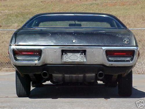

71440 gtx
- GTX (RS)
- Posts: 1005
- Joined: Tue Nov 25, 2003 2:34 am
- My Cars: 71 gtx 71 340 duster
- Location: I am here, or is it there? GIF image (animated, 49 frames)
Re: Correct placement of 1972 GTX emblems?
71 gtx 440 4speed air grabber blue on blue with white vinyl roofOption cassette player
Plymouth's gonna getcha!
There are 3 things that will live forever, cockroaches, Keith Richards, & slant 6

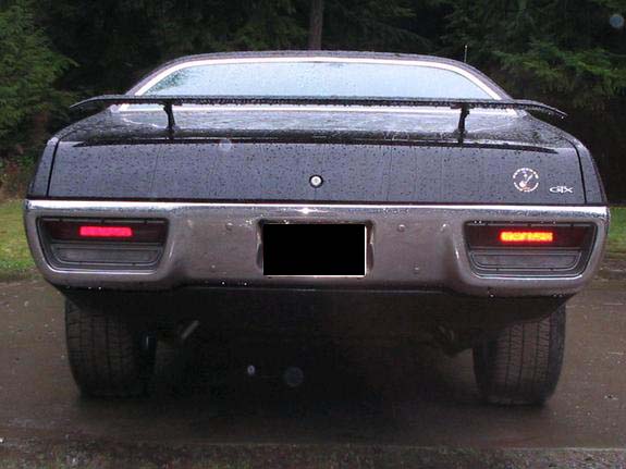

- 72RoadRunnerGTX
- GTX (RS)
- Posts: 593
- Joined: Wed Dec 27, 2006 6:44 pm
- My Cars: 1972 Road Runner/GTX
1972 Satellite Sebring
1972 Satellite Sebring(big block parts car) - Location: Seattle, Washington
I have spent countless hours years ago flipping the pages of Mopar parts catalogs, from that time, trying to pin a part number down accurately enough to place an order. It was a time before computers and microfiche and the books were all we had at my local Chrysler/Plymouth dealer where I worked a parts counter for several years in my youth. I have a copy of the 72' book now and am familiar with the diagram mentioned. My experience then has shown that these diagrams were meant to show the general locations of these parts only. I believe the location for the rear GTX badge above the circle bird is not correct. The cars around the dealer then, the 72' RR/GTX that I helped to maintain then, and my research more recently indicates to me that the correct location is to the right of the circle bird, with the circle bird shifted slightly to the left from the standard RR location.
- Attachments
- gtx rear.jpg (45.02 KiB) Viewed 35206 times
Last edited by 72RoadRunnerGTX on Tue Dec 27, 2011 12:56 am, edited 1 time in total.

Interesting what 72RoadRunnerGTX has said, and he may be correct. But here's a couple of thoughts.
We can agree that the placement of the fender emblems in the illustrations are in the absolute correct spots, not just in the "general" area, right? Why would the trunk emblem be illustrated any less accurately.
And it's also been my observation that other car body illustrations in the book, not just of our RR/GTX, show accurate representations of where their emblems/stripes correctly go. Why should the RR/GTX illustrations be any different?
Lastly, seeing as how Eric's pic above is an original paint GTX, the factory's placement of the decal is such that there wouldn't have been enough room for the emblem to be mounted to it's right, and their does appear to be "wear" in the paint above the decal where the emblem may have originally been mounted.
I can say that, of the handful of 72 GTX's I've actually see in the "flesh", none of them had the GTX emblem in the position that 72RoadRunnerGTX's is in, but that's just my experience.
Perhaps we will never know for absolute sure. But I'm thinking that using Chrysler's own illustrations as a guide is probably a good authority to go on. Otherwise, Galen Govier....call your office!
