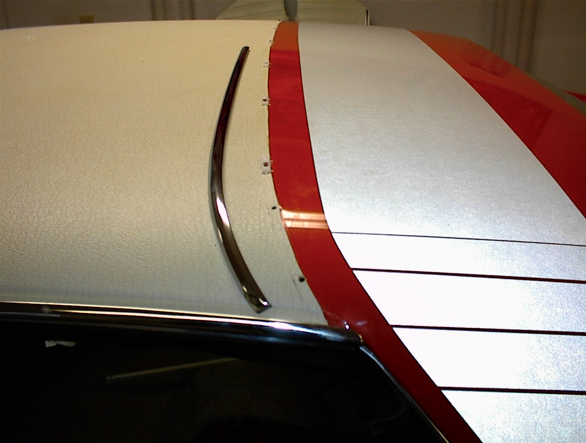

Post by BlackGTS » Mon Feb 26, 2007 11:01 pm
What I have are the studs with the plastic clips across the top and each side a hole 2" above the drip rail.I assumed that was for a clip that had a threaded end that a nut attached to on the inside of the roof.I had moldings that came with the car but not installed.After having a new top put on I have tried every way possible to get the moldings on and they almost fit but not quite.
The person that installed the top said the moldings were wrong.They come so close to fitting that I thought she was wrong.
I found a different set of moldings from a 73 but thet screw down at the drip rail.My headliner is dropped to install the molding and I can't see or feel a hole where a screw would go.
I was hoping someone that had a 72 with a canopy roof could tell me what is correct.

I have a 72 with canopy, and it has the studs across the roof with a hole on each side for a butterfly type clip (this clip is the stud that was referred to previously above). You may need to buy a couple of new clips, so be sure you get the style that has the rubber seal on the stud or the roof will leak.
The picture above looks correct. The last hole showing above the drip rail should be where the clips stud goes through. As I recall the moulding does take a small amount of pushing to bring the ends down (kinda springs up a bit when you unbolt the ends. I assume that is why they use a bolt on style clip to hold it, or maybe mine were bent a bit

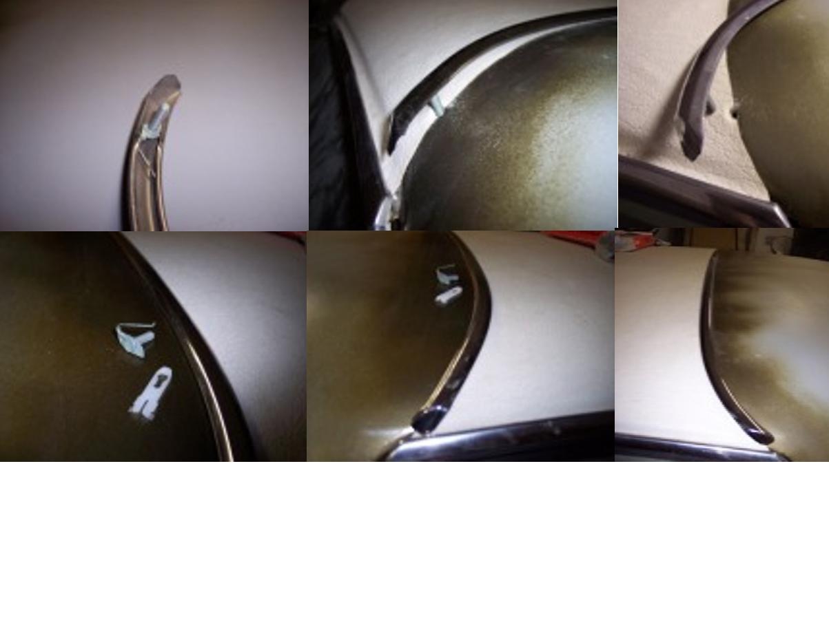

Took some pics on the weekend....
Not shown in the picture is the rubber seal and nut for the 2 metal clips. The rubber seal goes between the roof and the clip, and the nut goes on from inside the roof. If you're having trouble finding the hole on the inside of the car, I would suggest inserting a screw driver into the hole so that you can see where it come through.
Hope these help, and if you want higher resolution versions, pm me with your email address and I'll send them along.

Post by BlackGTS » Mon Mar 05, 2007 5:06 pm
Thanks for the pictures,they will help.One thing I see that is different is mine sets farther down into the driprail.I ground a little bit of the corner of the molding off and that seemed to help it fit flatter to the top.We are going to make another attempt at installing the moldings tomorrow.

Post by 72GY9Runner » Mon Mar 05, 2007 5:12 pm
Mine will sit farther down in the rail too!
Like I was saying earlier, it sprung up a bit when I unbolted it but when I tighten up the nut on the clip it will come down. It basically squeezes the vinyl snug into the drip rail area.
