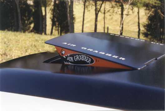

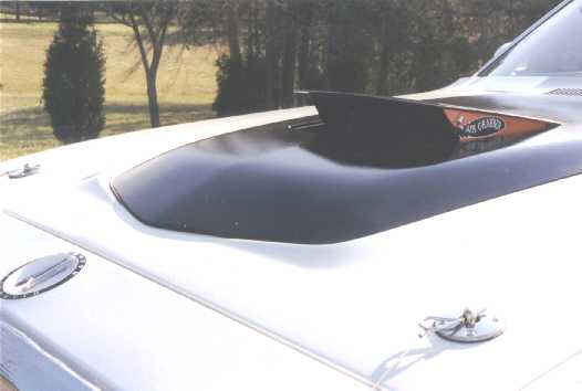

Post by bruce » Sun Jan 28, 2007 1:11 pm
What's that they say about a picture being worth a thousand words? Hopefully these pics of the scoop on my air grabber help. Good luck!
