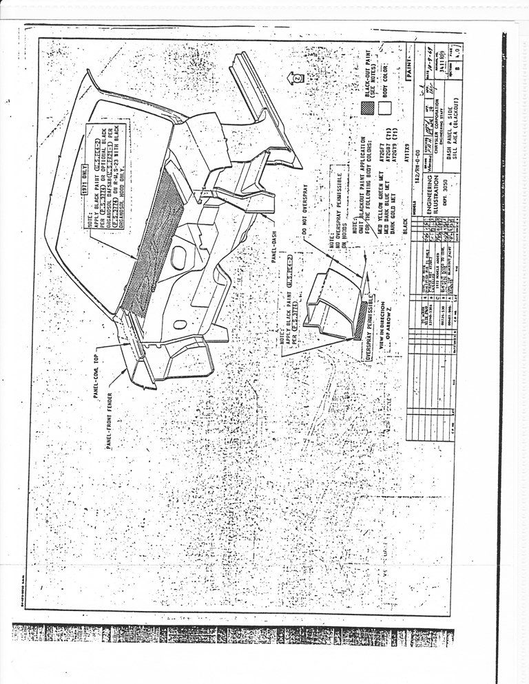

These two documents were posted. I can't read the revision block on the drawing which is for the 71 model year, but updated for 72. Could delete or continue the paint behind the bubble. No telling if it was the last revision.
The 72 body manual make no reference to the organisol.
I'd really like a better look at that revision block.

I have a copy of that paint document, and unfortunately the revisions do not address the V21 paint. They mainly reference removed and added mouldings for 72.

I guess what I'd really like to see then is the drawing that shows the 72 V21 stripes. That seems to be the missing piece of the puzzle.

This may be the most telling document as to factory intent for the 72s. See boxed note "1971 only" pointing to the cowl blackout....

Eric wrote:This may be the most telling document as to factory intent for the 72s. See boxed note "1971 only" pointing to the cowl blackout....
And thats definately painted on my 72, but like stated before I have a very early 72. So I guess I document that for the resto and redo it that way.
