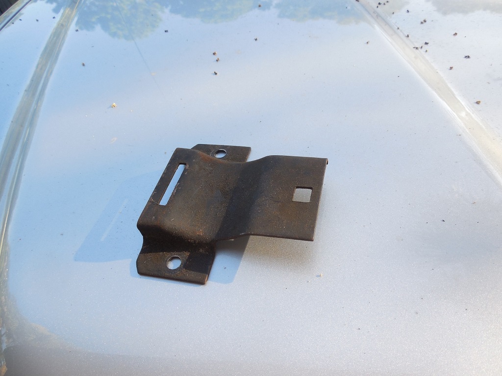

Does anyone have any close photos or factory drawing for the dryer and exact bracket used on 71 B-bodies? I'm trying to track the hardware to retain the dryer down bit having trouble finding the proper one.
Re: A/C dryer mount and bracket
This attaches with two bolts across from alternator.
That's it! Part of it anyway. I also need the mounting strap. Willing to part with it?

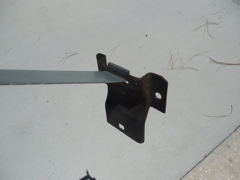

I don't think I have the strap. I'll look, but yeah, pm me.
I cut this piece of metal a little bit longer (I think) than mine. Wrap it over the canister and then you will need to bend the end back some and drill a hole for the bolt. Maybe put end in vise, like I did. I'm not sure, but I think that square hole takes a carriage bolt. I just noticed that mine just has a regular bolt installed (have to fix that). Good luck, Ron.
Excellent! Many thanks for your help
