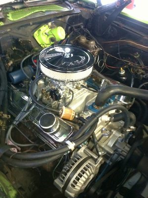

I got most of my stuff from Summit Racing Equipment! LoKar kit works great! Call them and talk to one of the guys and tell him what your needs are and he'll listin to you! And yes you got to change to the cable and not use any of the old stuff! I just built a 318 HP motor with a 904 trans and had to go with their system which is LoKar plus I used Edelbrock intake/ 600cfm Edlebrock Carb and Cam....... runs very good!
