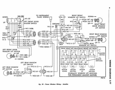

5) I have the option of getting a full set of power window motors out of the 73 runner. The owner wants to keep the windows in place, but I can pull the wiring, motors ect. Can I use my non power window regulators for this purpose or do I need to pull those out as well?
5a) when it comes to wiring, does anyone have the diagram on where the wiring goes or how power windows are wired? I do not have this option shown in my manual.

Post by 71runnerm51 » Sat Apr 25, 2015 10:50 am
power window wiring

71runnerm51 wrote:power window wiring
AWESOME!!! This is great! thanks for the help guys!
