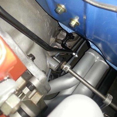

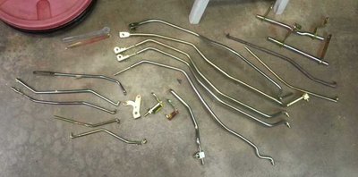

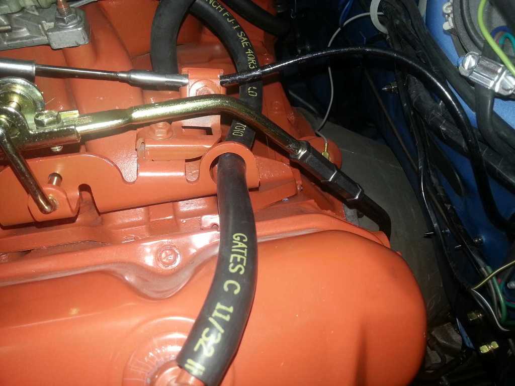

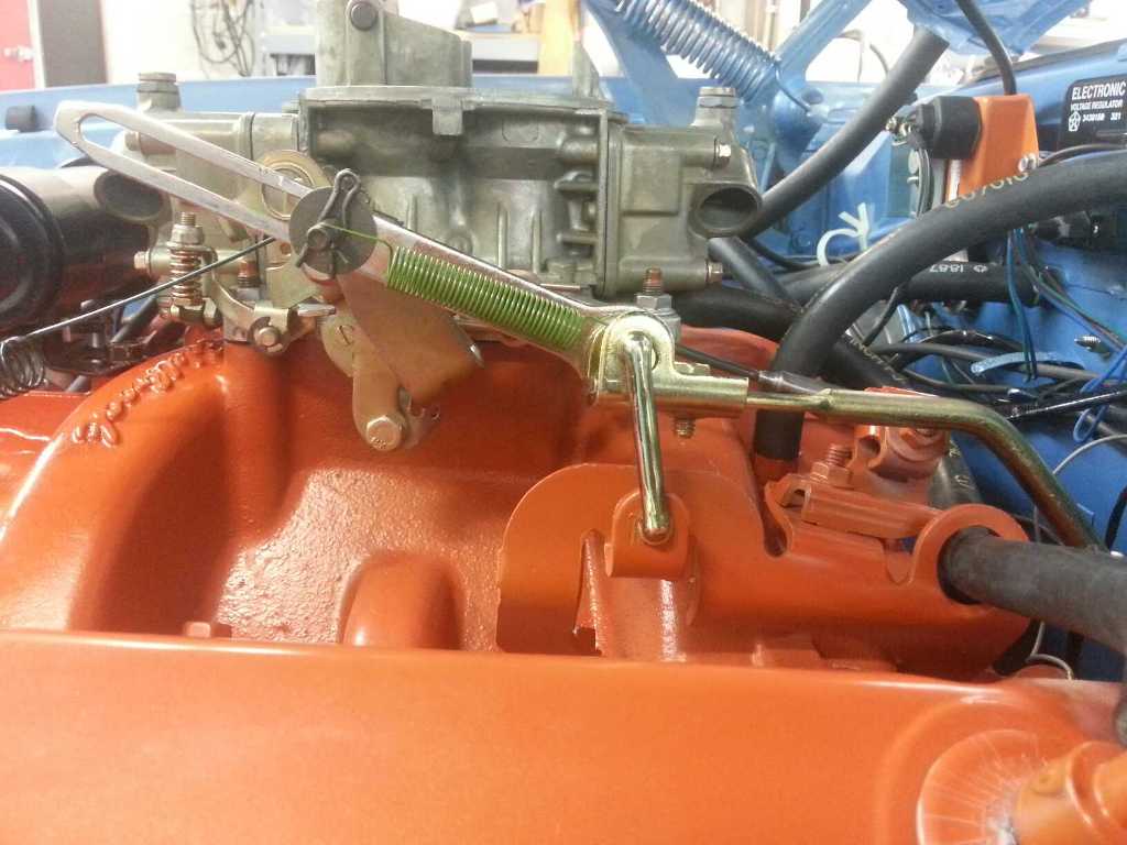

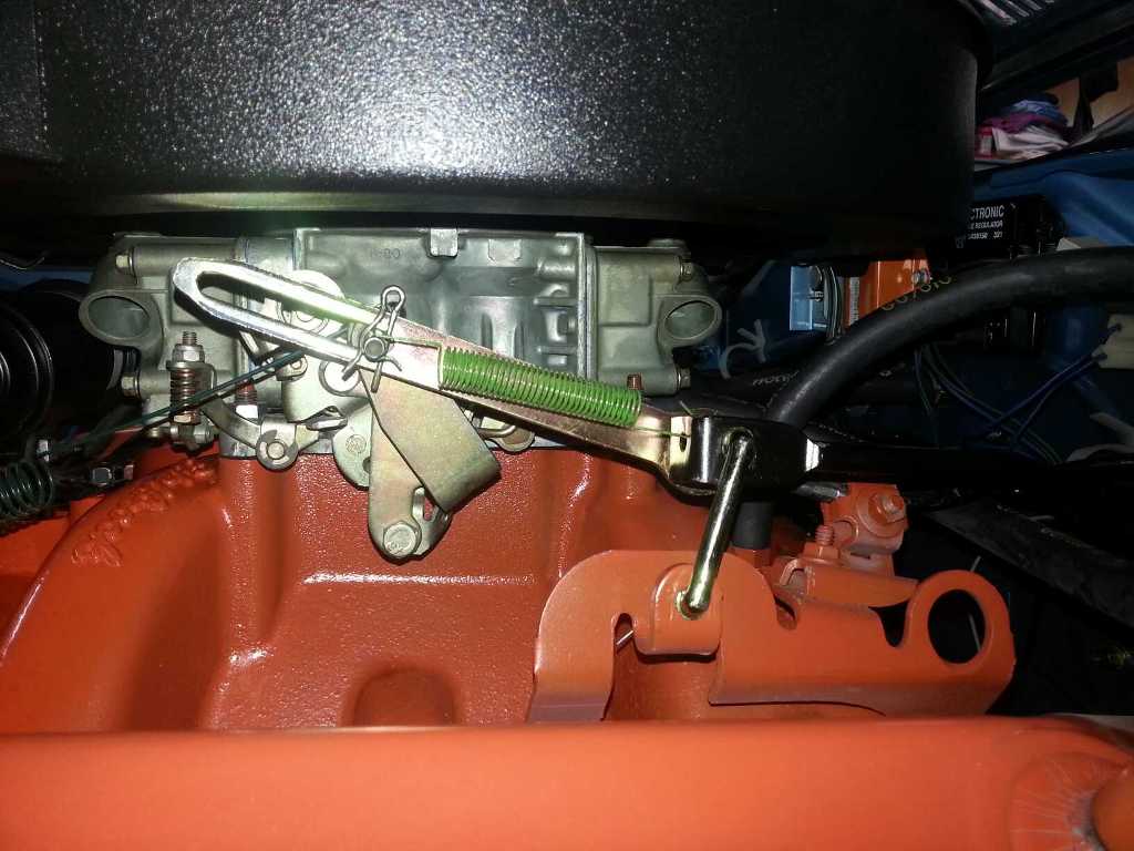

Thank you for the reply. Now that you mention it, I think this trans is out of a 66-67 Imperial. Not sure where the throttle rod came from though. You might be right with the lever at the transmissino being too short. Today I noticed that the throttle rod at the carb end is actually "bottoming out" on the bracket itself (attaching to the intake manifold). I am realizing what a hodge-podge this set up is of mine
Here are some photos. The geometry at the carb looks pretty wonky now that I see it in photos...

1. That is a Performer RPM manifold .. correct? It appears to be because of the runner and the height of the carb, resulting in the steep angle down to the linkage. The "adjustment" to the throttle cable clamp is close to what I had to do as well .

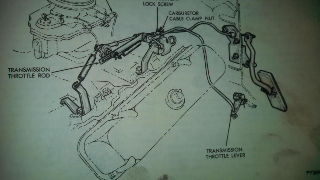

2. Look at your set up vs. the factory picture of the single rod. Look at the pivot link in each picture, ( where the front of the rod attaches to the manifold bracket). The factory has the link forward at rest ( idle position), yours is angled back at rest. For some reason, your rod is positioned back further at the idle position. That is where you're losing the travel.
3. Now look at the single rod in the factory picture. It has the adjustment on the top, by the engine, and yours is down by the transmission. I think this is where the problem is. You need to change to that style rod and adjuster shown in the factory picture. That should give you the play and full range you're going to need to get the full travel and make the proper adjustment- even with the sharp angle with the high-rise manifold.
4. Out of the linkage parts you have pictured, looking at the one piece rods from left to right, I would think the 1st rod maybe, 2nd possibly and 3rd more than likely( and the one I would start with), would be the proper part. 4 and 5- I seriously doubt it.

From the 71 Book on how to adjust the single section throttle rod... I may paraphrase here in couple places to save time, but most will be verbatim from the book. The purpose of this adjustment is to take out all the slop/ slack/ play between the carb lever pin and the transmission lever WITHOUT PRE-LOADING IT IN EITHER DIRECTION! Very important. The rod may want to rotate from side to side a little bit, ( which is normal from the way it is connected to the transmission lever), what we are concerned about is the back and forth play between the two. The reason for this is that the throttle rod controls a pressure circuit in the transmission which governs the speed at which the shifts are made.
1) Follow the detailed instructions on lubricating the linkage. (IE, just make sure it's loose and free moving- I don't think that is an issue since your parts look to be new and not all crudded up.)
2) Disconnect choke at carb or block the choke in the wide open position. Open throttle slightly to release the fast idle cam, then return carb to curb idle position.
3) Loosen the transmission throttle rod adjustment lock screw.
4) Use special tool c-4160 to hold the transmission lever forward against its stop... (Ok since no one has this tool, either have a friend hold the LEVER ( not the rod) forward against its internal stop. OR rig up a way to hold the transmission lever forward against its internal stop. A strong spring or wire (better) would work- just so there is no influence applied to the Throttle rod and the lever is held tight forward with no play to the rear.)
5) Adjust the transmission rod at the carb by pushing forward on the retainer and rearward on the rod ( opposite directions) with a slight force to remove all backlash. See fig 19, ( below). Tighten transmission rod adjustment locking screw. Tool, ( spring /wire/ friend ), must be in place at the transmission lever and all backlash removed when tightening the lock screw.
NOTE: The rear edge of the link slot must be against the carb lever pin during this adjustment.
6) remove the tool ( spring /wire/ friend) from the transmission throttle lever. check the linkage freedom of operation by moving the slotted link at the carb to the full rearward position and then allow it to return slowly, making sure it returns to the full forward position.
7) Re connect the choke linkage or remove the blocking fixture.

Excellent details and advice Road Chicken, many thanks! Tonight after work I'll swap out throttle rods and get the adjustment up at the carburator end where it belongs. Getting that link bar up or leaning forward at idle seems to be one of initial goals to getting this set up properly. After our discussion, I think that is definitely the root of this problem. I need to verify, but the lever at the transmission probably has plenty of travel left. If not, I will entertain the idea of a longer lever. Again, thank you very much for your advice. Paraphrasing the FSM helps big time!
71Satellite98661
- Posts: 245
- My Cars: 71 Satellite
Re: Throttle Rod binding
We might be in business now. I took one of the spare throttle rods, bisected a straight section, threaded both cut ends with 3/8-16 tap, added coupling and jam nuts then elongated the slot at the upper end of the throttle rod by about 3/4". I now have full stroke of both the throttle rod and carburetor throttle. Adjustments per FSM now leaves the adjustment slot right in the middle for fine tuning and I think I'm ready for a test run. Thanks for the help, I've added a couple of photos of the modification...
