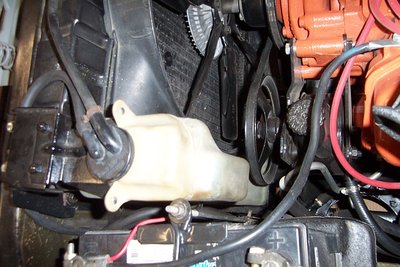

Here is the correct bottle on my 72.
Bottle was not available in 71
Was an option in 72
Standard in 73 and up.

This is the reproduction bottle that goes with the above pictured bracket, same set-up I used.
http://www.ebay.com/itm/Mopar-73-74-Dod ... cf&vxp=mtr

Wonder why the factory didn't pt one on the '71? Contemplating whether or not to pt one on mine

rr6pak wrote:Wonder why the factory didn't pt one on the '71? Contemplating whether or not to pt one on mine
Think 73 was the first year that it was a Federal requirement.
