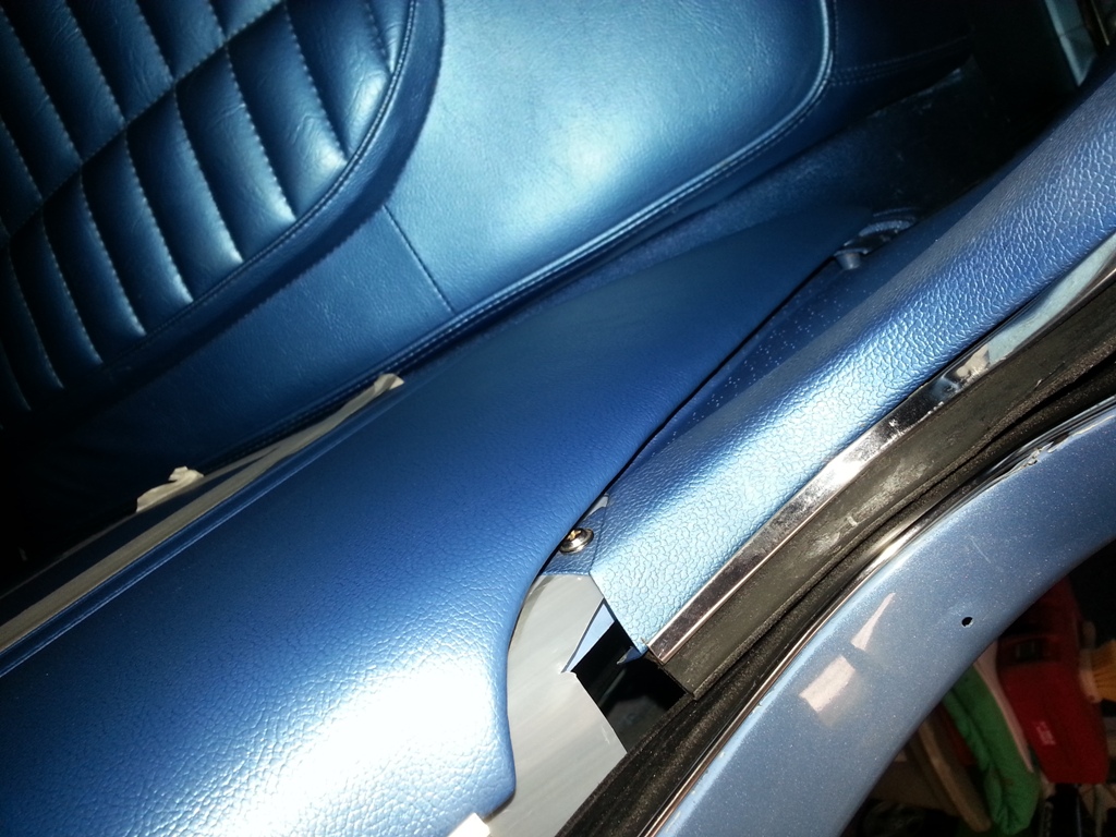

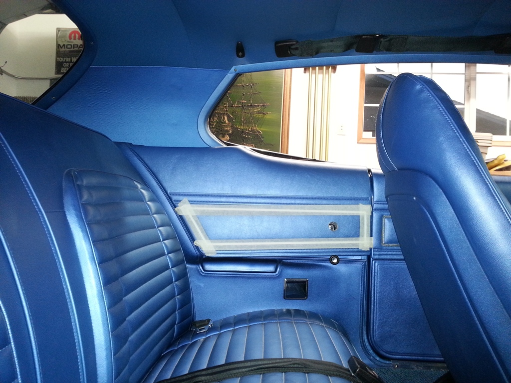

Thank you fellas for the feedback. It is surprising to think about all of the different rear door panels for all of the 71-74 Dodge and Plymouth B-bodies. Here are a few pictures that should clearly show what I am up against. Keep in mind that I've only just "hung" these for the photo and are not fastenened in any way.

For future reference and comparison. 73-74 rear upper in front and a 71-72 rear upper behind. Just a little bit different.

Scott thank you for taking the time to post those photos. The side by side comparison says it all. Well, probably not going to be easy selling these. Are your examples for sale? Lol!
