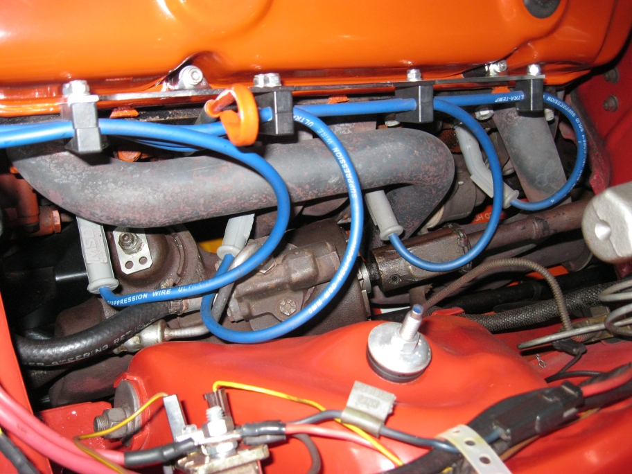

If they are running that close on only a couple, go to Jegs or Summit and look for Sparkplug boot protectors. They are about 6" of treated fiberglass that slip over most ends. I have angled plug heads with the manifolds so I needed two for cyl 6 & 8. so far so good. For a loom i used wire ties like they do in nascar. Cheap, fully custom to what you need, where you need it.
