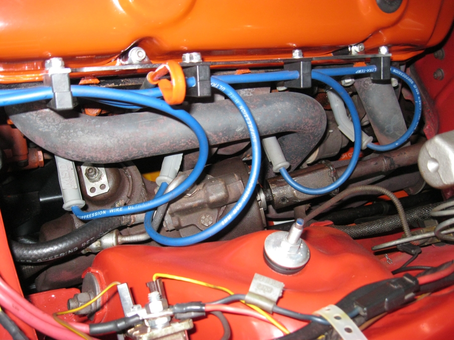

See below, I installed the wire guides purchased from Summit with MDS 8mm solid core Ultra-Temp wires. Routed near headers with no melting/burning problems for 6 years now.  The Summit loom part number is RNM-1104-90-C and sells for$99 now.  The wire set part number was MSD-3108 and is no longer available, but Summit gives you a MSD substitute.
