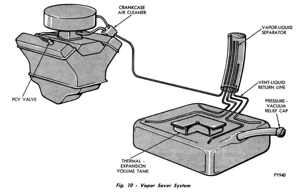

I think manual page 9A-6 shows better whats goes where. They call the "breather" a crankcase air cleaner. One connection goes to the fuel system vapor recovery tank. Another goes to the carb. vapor line. These may have check valves. The third connection goes to the air cleaner.

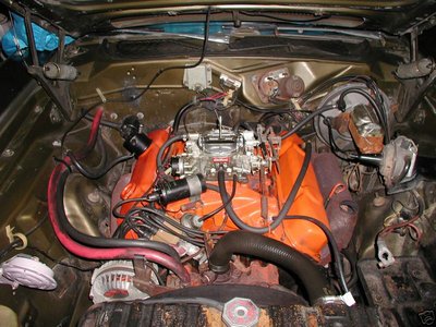

Post by Eric » Mon Dec 02, 2013 7:48 pm
hopefully these help
