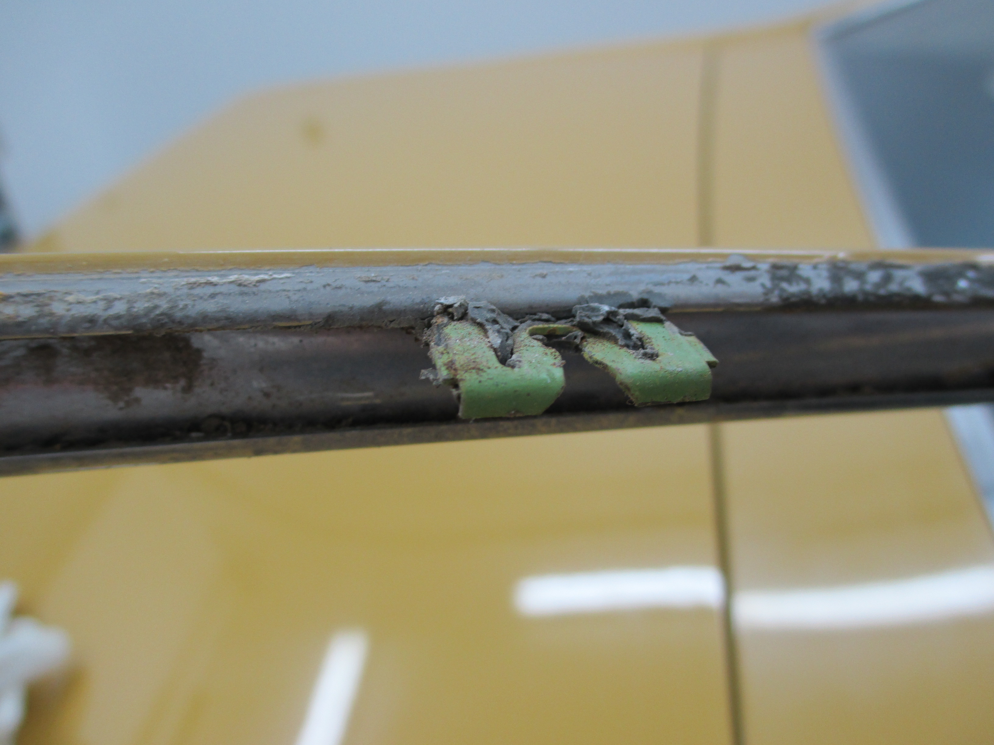

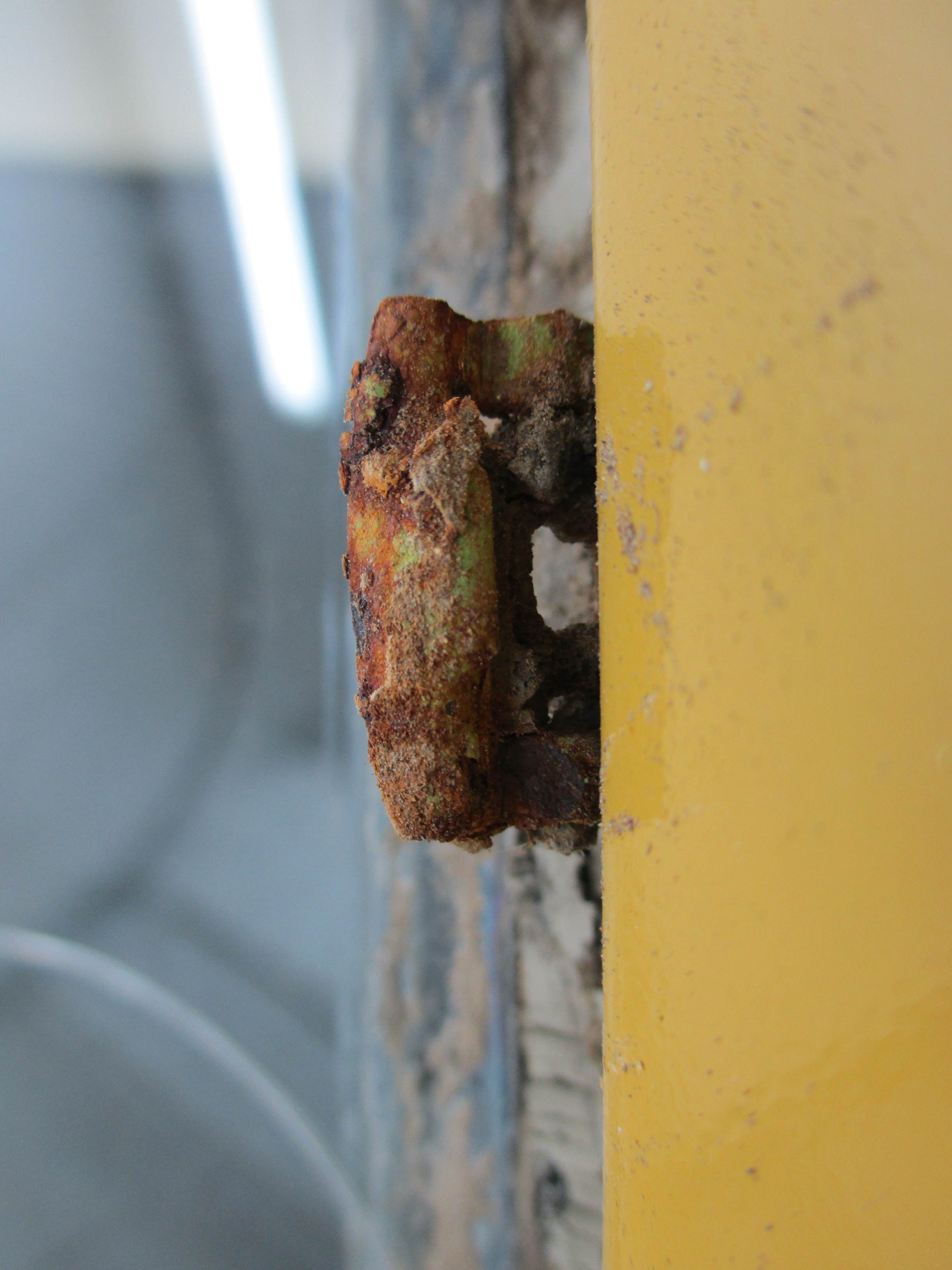

Post by Eric » Sun Sep 22, 2013 10:04 am
Here's what the clips look like, but if your car is anything like mine it will not be that easy. Someone previously tried to fix leaks around the glass with several different types of sealant including black silicone and trim adhesive. I had to run fishing line between the clips to separate the trim from the sealant. :mad:

Post by mopar71 » Sun Sep 22, 2013 3:33 pm
Oh boy! Sounds like fun,thanks for the pics Eric. :beer:
