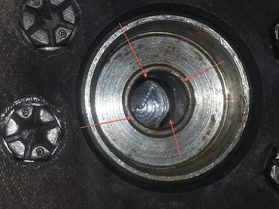

Guys, just to make sure: I lubricate inside the pilot bushing as indicated.
Also, the shop manual says no lubricant on the pilot end of the trans drive pinion or splines , but a bit of lubricant on the pinion bearing retainer sleeve,.
Sorry if I sound a bit thick, but I d not want to make this mistake again. Should have the pp and clutchplate back this week :beer:

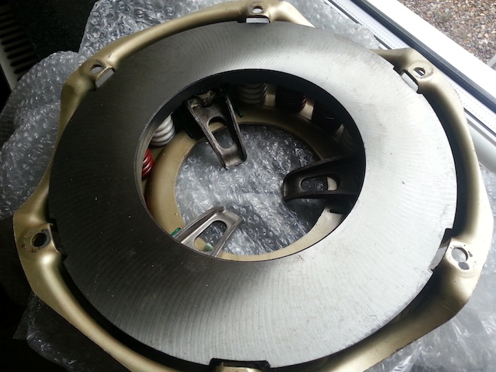

As as been stated, the 3 fingers should be the same height.
I've found the fingers uneven after even slight use.
Discovered that the adjustment nuts are not locked!!
So I adjusted them till they're the same height and tack welded.
End of that problem!

roelbest wrote:Guys, just to make sure: I lubricate inside the pilot bushing as indicated.
Yup. Teaspoon of grease in the pilot busing hole and a thin coating where the throwout bearing slides. "Thick" is not asking if your not sure :D

Let me clarify a this a little bit.If you have an oilite bushing it should be soaked in OIL before installation,and a half teaspoon of grease should go in front of the bushing in the crankshaft cavity.Per the book.

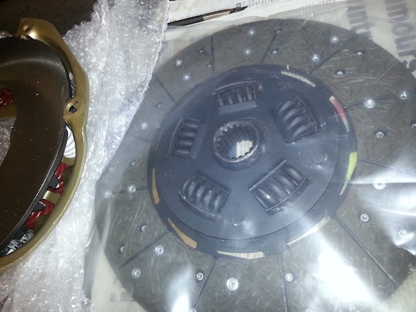

Picked up the clutch and pp today.
71bird, the pilot bushing was fitted when the motor was built, a while ago. All I can say is it looks like brass/copper? as per picture. I have no idea if it was oiled when assembled. All I can do now is grease it, I have also soaked it in a bit of oil as road chicken advised, by taping off bottom half and leaving oil over night..

Just for thought, when I said oilite bushing. That was a Mopar invention by the way. It is a Bronze,and something or another mix. That is impregnated with oil in the pores. It releases the oil over time, thats why it should be soaked to resupply the oil. Just food for thought.

Just a suggestion, but since you have the new parts available- why not take the measurements and re set the old PP assembly. That way, you don't lose out any money and have it on the shelf for the next time.
The bushing is a sintered bronze material. Small pores hold the oil inside and as that wears off the grease gets sucked in. Replace them every time you do a clutch. They do wear and if you can find the roller bearing replacement....even better.

[quote="road chicken"]Just a suggestion, but since you have the new parts available- why not take the measurements and re set the old PP assembly. That way, you don't lose out any money and have it on the shelf for the next time.
Great suggestion!!
And If the flywheel's off, you can do this on the bench.
Don't forget the disc!!
