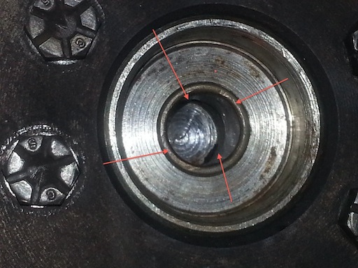

Picked up the clutch and pp today.
71bird, the pilot bushing was fitted when the motor was built, a while ago. All I can say is it looks like brass/copper? as per picture. I have no idea if it was oiled when assembled. All I can do now is grease it, I have also soaked it in a bit of oil as road chicken advised, by taping off bottom half and leaving oil over night..

Just for thought, when I said oilite bushing. That was a Mopar invention by the way. It is a Bronze,and something or another mix. That is impregnated with oil in the pores. It releases the oil over time, thats why it should be soaked to resupply the oil. Just food for thought.

Just a suggestion, but since you have the new parts available- why not take the measurements and re set the old PP assembly. That way, you don't lose out any money and have it on the shelf for the next time.
The bushing is a sintered bronze material. Small pores hold the oil inside and as that wears off the grease gets sucked in. Replace them every time you do a clutch. They do wear and if you can find the roller bearing replacement....even better.
