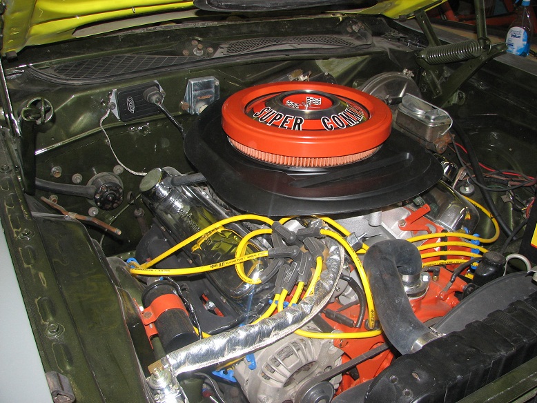

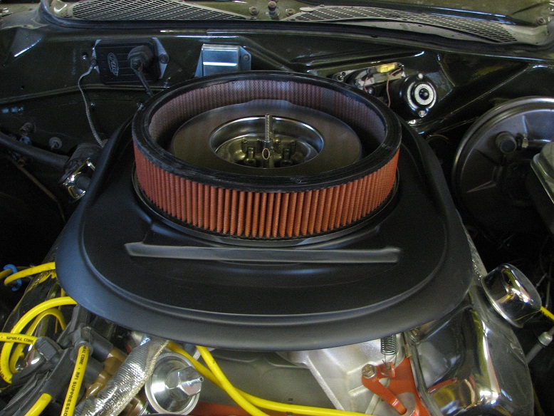

Well - I was able to accomplish my goal- restore an original-looking airgrabber air cleaner element while using the Performer RPM on a 440.
I used a fiberglass reproduction base - removed the middle part and fabricated in a drop-element base in its place. Wouldn't fool anyone and that isn't my intent. But I do like to be able to restore the function of the grabber and get back to a stock-like look.

RS23U1E wrote:I used a fiberglass reproduction base - removed the middle part and fabricated in a drop-element base in its place. Wouldn't fool anyone and that isn't my intent. But I do like to be able to restore the function of the grabber and get back to a stock-like look.
How much gap is there between the lid and the base? Looks restrictive... possibly to the point of defeating at least some of the performance gain of the RPM.
RS23U1E
Posts: 46
Re: Performer RPM fitment
Post by RS23U1E » Fri Feb 03, 2012 12:57 pm
I too am thinking about that. It is tighter than I want it to be inside and definitely costs HP. The stock lid on this drop base creates a pinch point where it dips down just inside the filter element. At that point - I have about 3/4 of an inch with the 2.75 inch tall element. On a stock air grabber base and lid the space there is about 1.5 inches, but the shape is different of the base so it is not a pinch point.
Its easy enough to go back to the 14 inch open element drop base when its in 'go' mode rather than 'show' mode. I just prefer the stock look if the hood's up.
