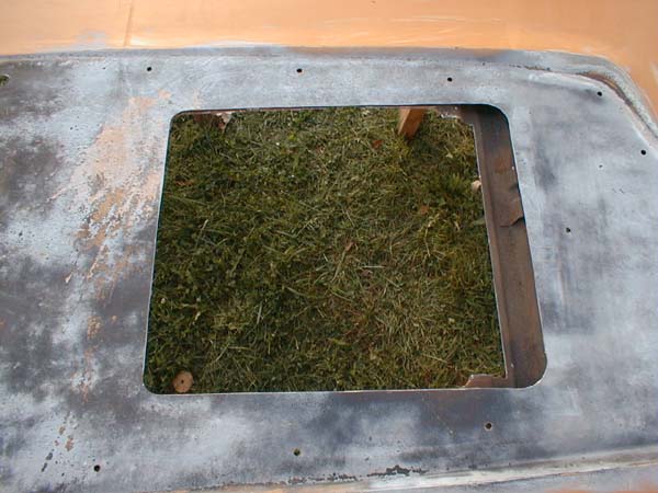

Post by Eric » Mon Mar 06, 2006 9:03 pm

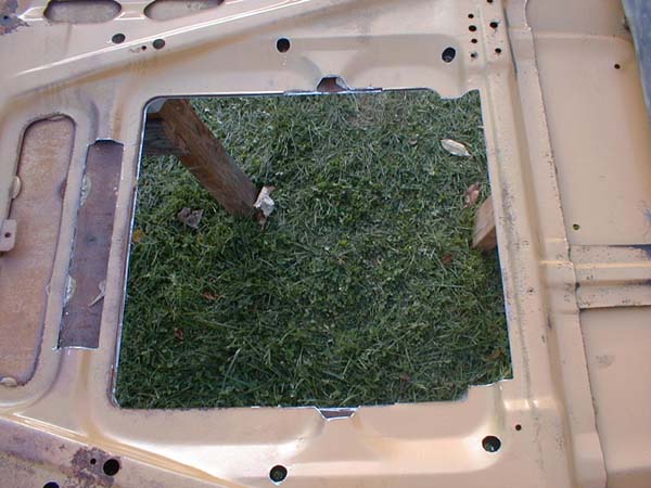

here are a couple of photos of when I made one from a satellite hood. Basically there is no hole to cut on the underside, you just cut out the braces. The hole above lines up with the curve of the brace at the back and is cut a little larger than the brace at the front. I had the benefit of using an AG hood as a template at the time.
Post by Eric » Mon Mar 06, 2006 9:05 pm
2nd pic
