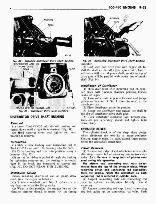

With crankshaft at TDC, factory specs have the distributor drive gear slot running parallel to the camshaft, looking down onto it through the distributor hole. This has the distributor oriented with the vacuum advance unit on top and to the front of the motor. Number one plug wire is then located at roughly the six o’clock position on the cap looking from above. Will the engine run any other way? Sure it will. Find TDC compression stoke, locate where the rotor is pointing, and place number one plug wire there. I had to position my drive gear a tooth off to allow clearance for the aftermarket fuel line/fittings and maintain correct number one plug wire location.

That's the exact information I needed, thanks a bunch! :D
Yeah, it'll run as is, but I want to put the drive gear "slit" parallel with the cam and the #1 plug at around 6 o'clock just to be "correct" (with the engine at TDC of the compression stroke, that is) since I'm a little anal about things. :beer:
