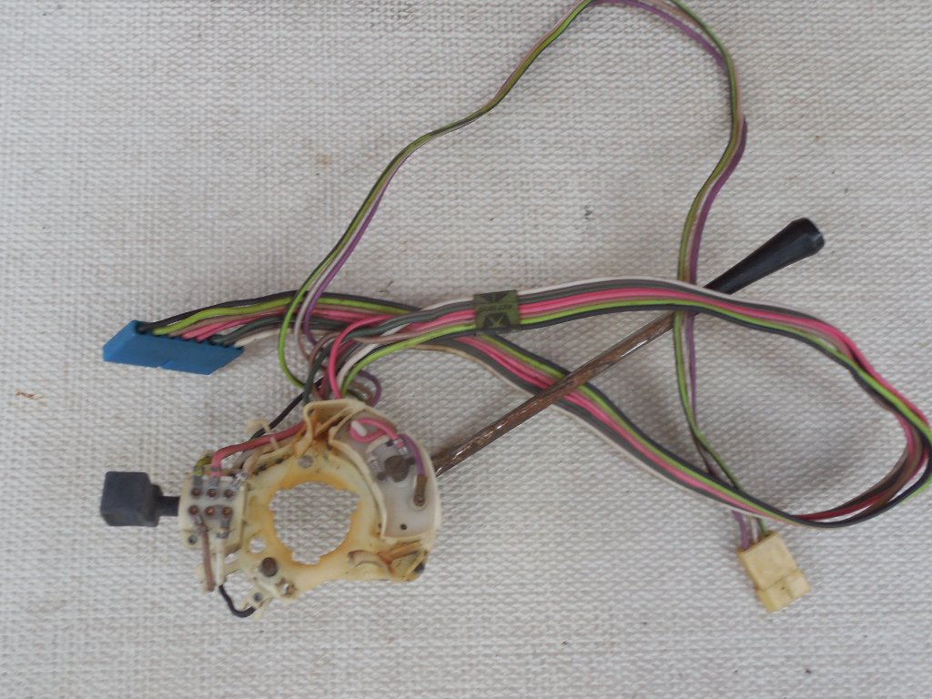

Posted: Thu Oct 25, 2018 5:41 pm
by rradar71
DSCN4469 (2).JPG (150.8 KiB) Viewed 49065 times
Any help?
