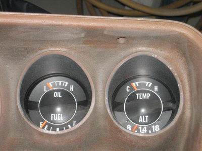

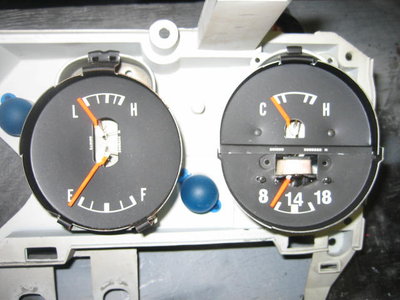

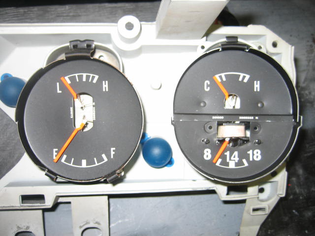

Hello, I just got finished doing another upgrade to my project. I wanted to remove the factory AMP gauge and replace it with a VOLT gauge. I did some reasearch and found that a CP7985 Sunpro Volt gauge would work for a start, so dissassembly of my gauge cluster and a lot of thought and modifacations had to be done to the gauge base and also to the new Volt gauge and I used the original /factory AMP gauge face-(modified) and installed it back onto the Volt gauge. So it can be done with a lot of time . I am going to post a few pictures...

2nd picture with lens cover installed

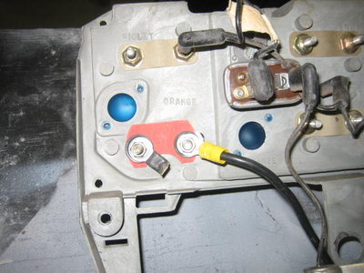

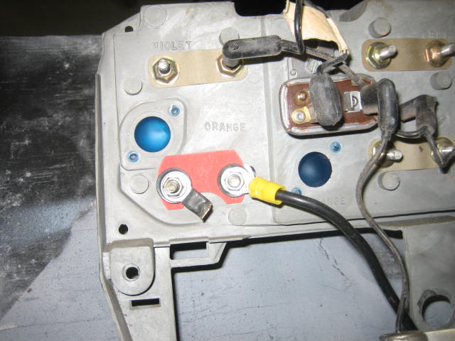

3rd picture of the back side of the gauge cluster

Picture of the gauge cluster with bezel on

another great Idea I may have to steal from you! looks factory!
Re: Amp gauge to Volt gauge conversion to look factory
Thank you!... The volt gauge you can get at an Autozone...for less than $15.00.... from there it's just a lot of time and having the proper tools to do the job. It was a saftey issue for me to change from the original AMP gauge to a volt gauge. Especially since I am going to intall a New Flaming River High output Alternator.
