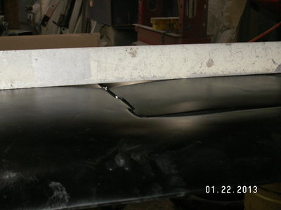

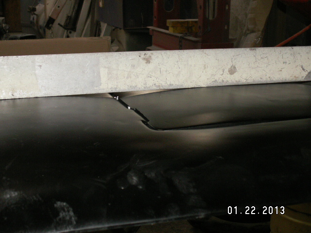

I purchased a PG Classic Air Grabber Bubble & Door and it was a total piece of junk. The bubble was not even close to the original part. The air box door had stress cracks out of the box. The fiberglass in the middle of the bubble sags down 3/4 of an inch from where it should be. The contour of the bubble is incorrect as it dips down instead of arching up. The bubble weighs over 35 lbs by itself and adding filler to try and correct the defects would only make it heavier. I doubt my rebuilt stock hood hinges would even support the added weight.
