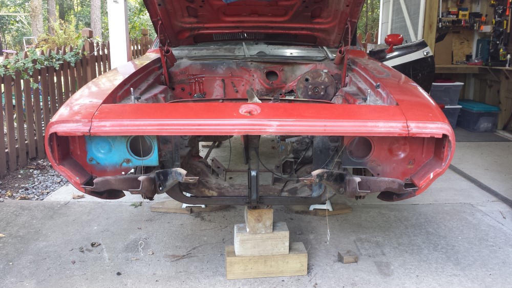

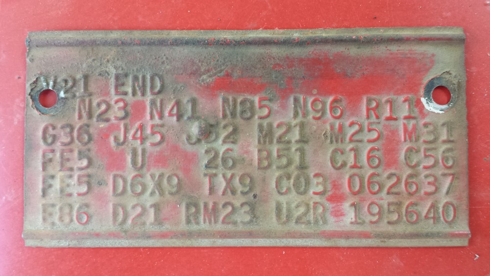

Fender Tag I researched serial numbers and so on, and here is what I found and also some of my concerns:
The passenger side fender is blue, plus it never had a GTX emblem on it. There are also signs of under paint rust bubbling on the passenger door, indicating possible body work back in the day, perhaps due to the accident that cost the car the fender. While removing the chrome trim on all of the wheel-wells, I noticed they were all screwed in except for the replacement fender, which had the chrome trim riveted in instead. Not sure if this identifies what kind of car it came from or not.
Blue marks on the fender, next to some old food that the little shits who ate my build sheet left behind.
No GTX emblem on passenger side

Re: Inherited 1972 Roadrunner/GTX 440
It's difficult to see, thanks to newer scuffs and crap being spilled on it while sitting in his garage, but there are clear rust bubbles under the paint toward the front of the door.

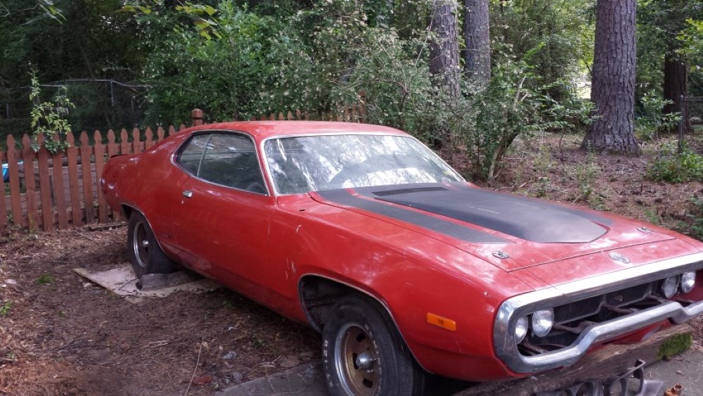

While on this picture, it seems to have come with longitudinal stripes, but in reading online, shouldn't there be a V something in the fender tag? I read it was a V6 for 71 and earlier cars. Is it possible the stripes were put on during the unknown years? I also can't find any information on the fender tag decoders for that initial V21 that is partially cut off from the screw hole.- 72RoadRunnerGTX
- Posts: 594
Scheduled production date (C03) December 3, 1971.
Replacement driver’s door is from another Dec ’71 Windsor built “U” code RR/GTX.

Cool. Thanks. So, the stripes and RR sticker on my car are clearly not Roadrunner GTX U code original stripes? Is there a code on the fender tag for the longitudinal stripes? Do you know what the V25 means on my fender tag?72RoadRunnerGTX wrote:Scheduled production date (C03) December 3, 1971.

- 72RoadRunnerGTX
- Posts: 594
I see V21 (hood stripes), not seeing V25 (deck lid Stripes). Reads like they need to be ordered together. If you look at the details of the original deck lid stripe I posted, you can see some differences.

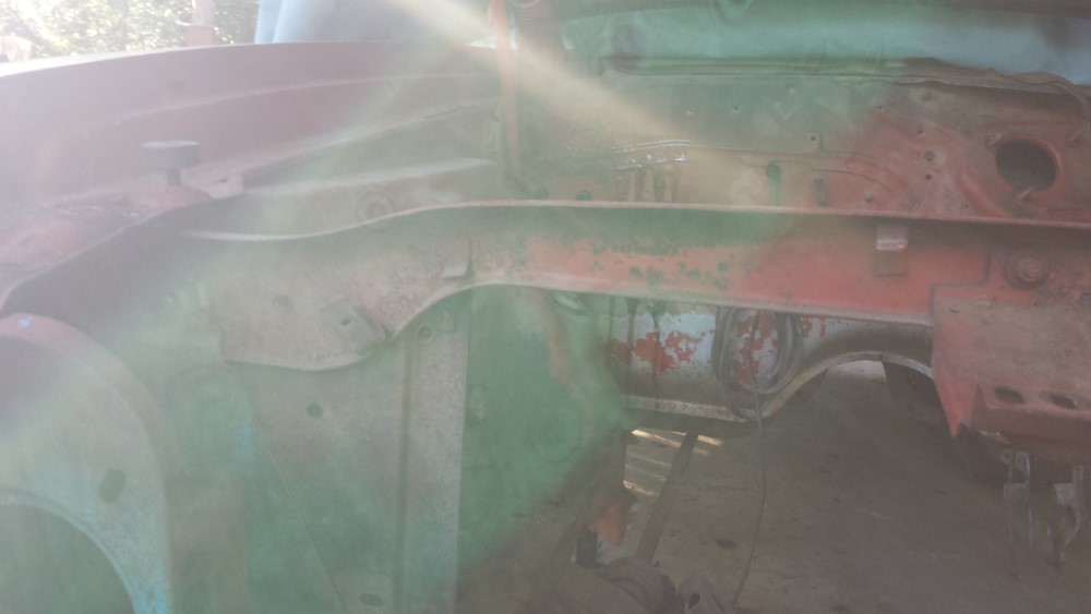

OK, I found the stamp on the cowl, it was just hard to see. It matches the sequence number.
It may be difficult to see in the pic, but it looks pretty smooth on the area under the yellow pic As the radiator support curves down toward the driver's side headlight, I see a stamp marking. It's upside down, facing the firewall. It appears to have 3 numbers, then a letter, then 3 more numbers. There is something similar on the passenger side, but in a slightly different location and facing forward instead of toward the firewall.
I'm seeing two different numbers on the radiator support, neither of them are in the vicinity of the yellow sticker as you pointed out in your picture.It may be difficult to see in the pic, but it looks pretty smooth on the area under the yellow pic As the radiator support curves down toward the driver's side headlight, I see a stamp marking. It's upside down, facing the firewall. It appears to have 3 numbers, then a letter, then 3 more numbers. There is something similar on the passenger side, but in a slightly different location and facing forward instead of toward the firewall.

- 72RoadRunnerGTX
- Posts: 594
I would feel around under the anti-freeze sticker, have seen some core support stampings in the top of the core support. The smaller numbers are just part identifiers or part numbers for the core support pieces.
- Road Runner (RM)
- Posts: 39
- Joined: Mon Nov 14, 2011 5:25 pm
- My Cars: 72 Roadrunner/GTX, 440-6pk
Well, I'll be damn. You're good. Right under the anti-freeze sticker, more toward the centerline of the car, was the sequence number stamped in, and it matches. So I guess the radiator support is original to the car, but obviously not the passenger fender and apparently not the heads.

So, somewhere along the line a few mistakes were made with regards to the stripes. As far as I can see, there are basically two theories:72RoadRunnerGTX wrote:I see V21 (hood stripes), not seeing V25 (deck lid Stripes). Reads like they need to be ordered together. If you look at the details of the original deck lid stripe I posted, you can see some differences.
1. The dealership only checked V21 as opposed to both V21/V25 when it was ordered, and the factory allowed it to be ordered with just V21, even though the spec sheet you had says both should be checked. It was built correctly, and then either the dealership or the first owner said "this thing looks stupid with longitudinal stripes only on the hood, so lets get them added to the trunk." At which time they just ordered the regular RR decal as opposed to the RR/GTX decal combo and nobody ever noticed the difference.
2. It was ordered as V21 and V25 and the factory screwed up the fender tag and also screwed up the RR/GTX decal on the trunk lid.
Theory one seems more likely, but I'm interested in any other thoughts. Thanks.
