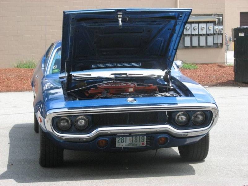

On the center section on my 72 grill as like many out there it does not lay flat to the bumper..Is there a way to maybe heat it or whatever to get it back to laying flat?? Any help would be greatly appreciated..

Mine is like that and I see it as a "badge of speed"! i.e. high speed wind flowing over the lower bumper and pushing the center grill piece up slightly. The higher the "bow" the longer & higher the speeds of the car have been! This entire grill is all original and 38 years old now!
That's my story and I'm sticking to it!
FWIW when I restored mine, I left it like it was. Just cleaned & painted it! Wasn't about to try and "reform" it, especially with heat or anything else. A "bowed" '72 Road Runner ORIGINAL grille is a thousand times better than a (1) melted one, (2) broken one!
