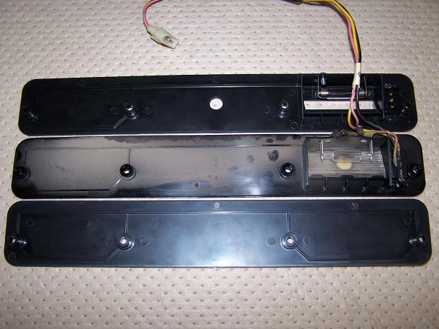

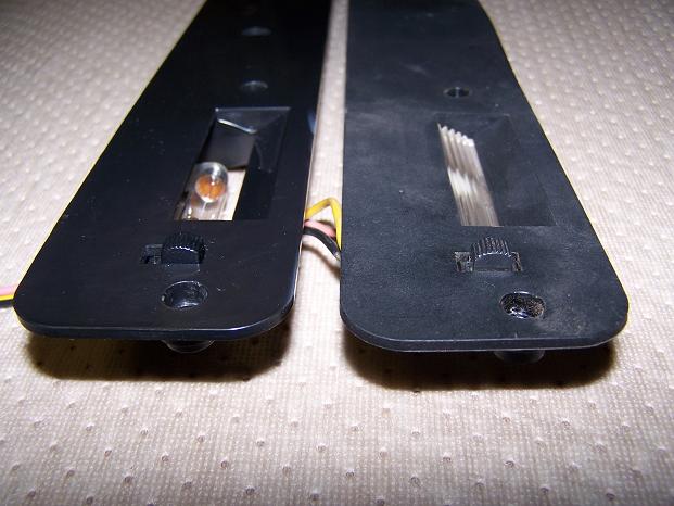

by jsbrown
Got the first couple of base protos this week (a blank and a lighted base w/ fader hole). Next step is texture matching and moving on to the lens. The detail is matching GREAT. Only difference is the bulb mount. The switch assy is dead on. Dimensionally excellent. Slightly stiffer than an original piece to boot, so it should hold up better on the sagging problem.

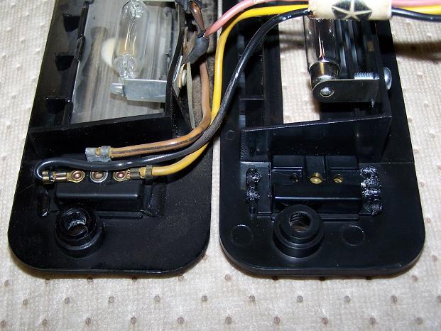

by jsbrown
Backside of switch compared to original...

by jsbrown
New blank, original assy, and new base for fader/lighted version.

by jsbrown
Question for folks on the switch. The proto doesn't have the wiring terminals installed in the switch, so perhaps that's the reason for this, but it acts like a two position switch. I would always mess with these to get the switch to stop in the middle so the light didn't ever come on. Was the switch intended to be a 3 position switch or is that how a fatigued assembly acts? I'm confirming with the manufacturer too to find out if they think this is an artifact of the terminals not being in place yet.

by 72RoadRunnerGTX
I've had a couple of those original switches apart, electrically speaking pretty poor design. Internally, pretty clear it was intended to be a two position switch only. A real center "off" position for map/dome lamp switches is very common for many other make vehicles over the years but don't believe it was intentional for this particular application. It's the heat and current draw of the incandescent bulb that causes the most issues with this map light assembly.

by jsbrown
Thanks folks! Sounds like we'll pursue the 2 position setup. I really appreciate the feedback on this!
As for plastic, its an ABS plastic. I'm not an expert by any means as to if there are different grades though.
Regarding the bulb heat, the bulb holder that's going into the new assemblies will support a bulb type that's available in an LED array. I need to try a few and see how some of them look when I get a lensed proto back.
