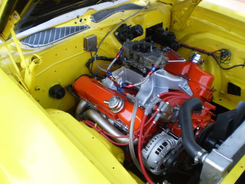

Everytime i look in this topic theres new pics.lol
Its exciting!

That's a good lookin' engine bay. I don't think I could fit an intake that size on mine!
'72 Road Runner

Post by ARI440 » Sun Aug 23, 2009 11:35 pm
I have no air filter on yet ,its very close to the hood
working on an AIR GRABBER hood ,so it will be able to use an air filter
looking to get a 1050 dominater to fit on an ovel air cleaner
the moter : 446 ci 12.5 comp 585/255 solid cam stage 4 ported heads ported M1 and a 750
5000 stall 727 manual valve body 8 3/4 .... 4.10 gears

Post by ARI440 » Sun Aug 23, 2009 11:39 pm
30 - 10.5 good year eagles slicks on a 15-8 rim
