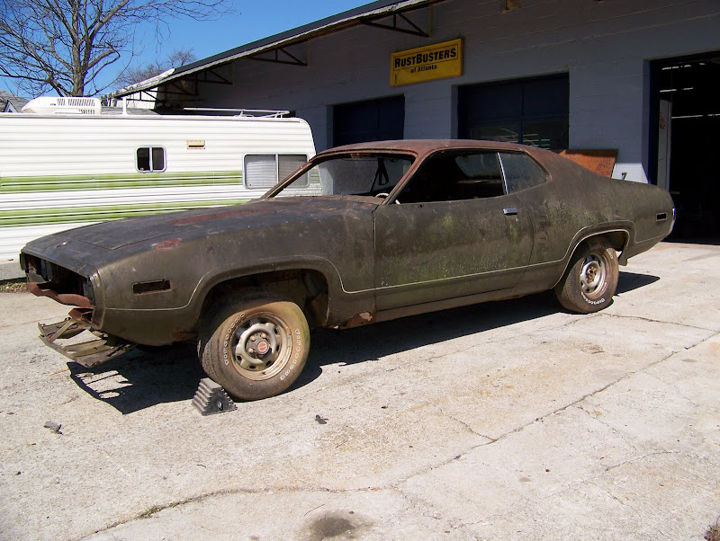

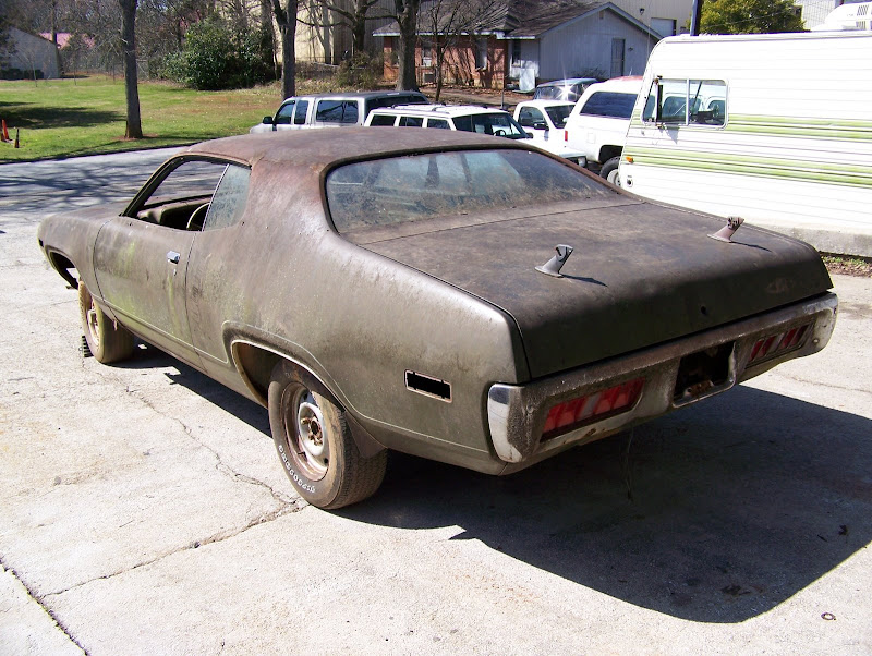

how it arrived at the shop:

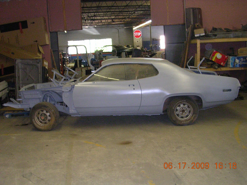

and how it looks currently:
Note that the car was just sand blasted and primed. there's minimal bodywork done to the car at this point. There are some BAD areas (inside the trunk channel, for example) pinestraw was just packed in there.
The car is GY9 Tawny Gold. It had a Gold vinyl top (I need info!!!) and had an ember gold interior...it's super pimp.
It'll be restored with a few minor changes (because it's MY car). I'll probably have the bumpers painted, and I"ll probably end up with 4 wheel disks instead of the drums.
interesting options from the broadcast sheet. it's got the hemi XHD suspension, and HD shock package. *info here would help too!*
