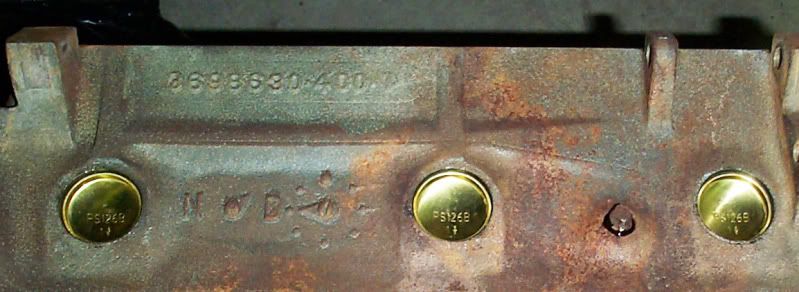

if the block is out of whatever it came from, the date code is on the side of the block on the passenger side. i believe you should have a letter (i think '66 was A, so should say F) then 400 and be stamped HP after that

Okay, so the designation for HP is on the passenger's side...landon1 wrote:if the block is out of whatever it came from, the date code is on the side of the block on the passenger side. i believe you should have a letter (i think '66 was A, so should say F) then 400 and be stamped HP after that
This one turned out to be a 76-78...It's good though to know for next time..thanks!

no, on 440s there is a "pad" flat part on the driver's side of the block that would have the stampings, on the B blocks, it's under the distributor, i believe - you can't even see my stamping, due to all the paint and grime. casting numbers are on both sides of the block, the passenger side also has the date above the casting number. there will be other markings as well
