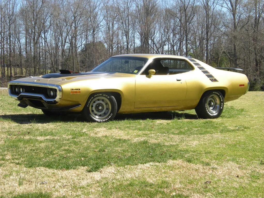

After a busy year, almost to the week....I am done. I am thrilled with the way it turned out.
What do ya think?

The car is beautiful and like I've said, I can't wait to see it! After seeing how nice your Cuda was, I'm sure this one is just as nice! See you did your stripe and spoilers RIGHT! :D
I also envy your productivity in getting it done in such a short time. My Road Runner is going on 4 YEARS being in pieces. :cry:

I agree with Bruce,Your car turned out very nice. Did you
have any trouble with the strobe stripe? I am
trying to get my car done in time for Carlisle in July or
Ohio in August. I started in Aug. of 2006.

I had no trouble with the stripe. I used the connection union of the rear window trim as the center point of the car, then measured the middle stripe piece and marked the center of it. Then I put a piece of masking tape on the top center of the window almost up to where the stripe starts so I could keep the to centers met. I then just started measuring and using pieces of masking tape to outline a pattern as to where I wanted the stripe to go. It took me a total of a little over an hour. Just keep it all soaking wet with a spray bottle of water with a little bit of Dawn added. I ordered my kit from Graphics Express, I was impressed with all of the decals.
Good Luck, show us pics........

Lookin good Barry. Seems it's been a good year for second generation cars. Took me almost exactly the same amount of time with mine. (Course I did have a little extra motivation)
