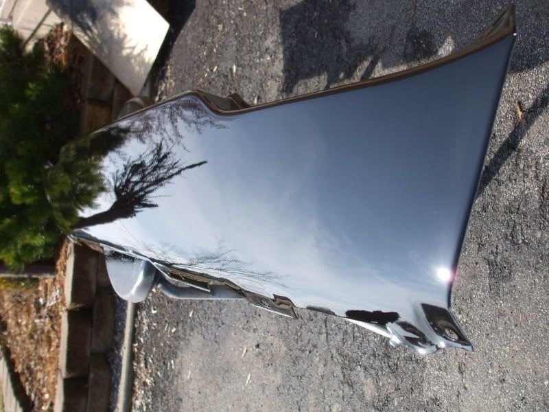

P.S. Been playing around doing some body and paint on some of the parts for mine I have here. Decided to go Black with the black canopy top and a Black 71 stripe. It will be years in the making, but I am doing it for the fun. Did front and rear valance so far, actually coming out very good. 25 years of spraying gel coats has helped out. If anyone has lots of pictures of totally black cars I'd love to recieve them --
dwilson278@cogeco.ca
Rear Valance here. Not bad for using a Princess Auto $18 spray gun
