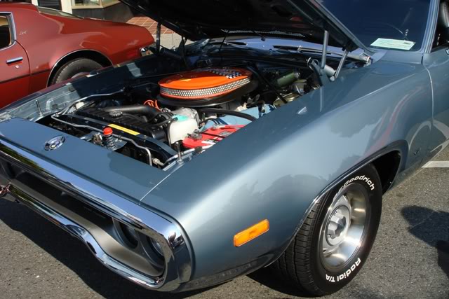

I just saw this thread for the first time and listen to your video of your engine running. What size cam are you running in that 440?
1971 Plymouth Roadrunner
383/4 speed/Air Conditioning
- 72RoadRunnerGTX
- Posts: 594
Re: 1972 Road Runner/GTX restoration
It's a Mopar Performance P4529270 "Resto" 69-71' 440 Six Pack three bolt re-issue. 268/284 .450/.458 lift. Basically the same grind used originally on all HP big blocks around that time.

Wow that actually sounds really good. I plan on going with a MP .474 grind and thought it might be a tad quite in my HP383. I'm guessing that yours sounds good cause of the headers. What size exhaust and mufflers are you using? Do you like the performance of the cam so far? And how hard is it to tune a six pack setup? My old man is telling me not to do the six pack setup because its hard to tune and work with as far as reliability.
- 72RoadRunnerGTX
- Posts: 594
TTI headers (2" primaries) into their 3" x-pipes and Dynomax Super Turbo mufflers. Sounds a bit different from that video with the tips on it now.
How do I like the cam? Love it, 19+Hgs of vacuum at idle, very streetable and goes like a bat out of hell.
Hard to tune a six-pack? No, with basic carburetor knowledge it's just like tuning three separate Holley's, they just happen to be on the same motor. There are a few specific tuning issues associated with the set-up, plenty of info available on-line here and elsewhere.
