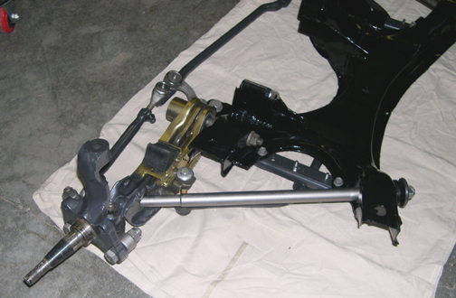

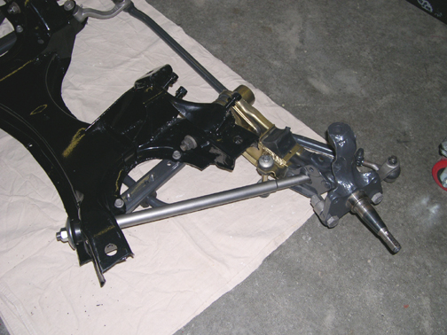

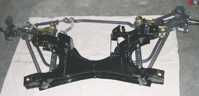

Well, looks like all the Saturdays I've spent working at US Car Tool might be paying off. This is all powder coated and reassembled using mostly poly bushings (rubber for the lower control arm pivots). I also used some heavy-duty aftermarket strut rods since mine were bent, like so many factory strut rods are...
They offer this as a complete service for their customers if anyone is interested. Check their website: www.uscartool.com.

Yeah, I'm pretty happy with it. Some of the colors aren't dead-on correct--due to a foul-up at the powder coaters. The "raw steel" stuff like the lower control arms and sway bar are too dark. But since I'm not looking for a concours resto it's cool. It sure looks a thousand times better than it ever has! And now they've gotten better with matching the proper sheen that the black of the k-member SHOULD have so it just keeps getting better and better for the customer's cars.

Are those the bigger strut rods that are offered? My stock ones don't have that stepped down section.

Hey Jon!
Yep, those are the bigger strut rods. If you saw the stock ones next to these you could tell how much bigger they are in diameter--they seem about twice the size.
We removed my k-member as a unit. Simply took out the torsion bars, took the upper control arms loose from their mounts and then dropped the k-member. Yep, the car was on the lift at US Car Tool when we did this, but it was REALLY simple...

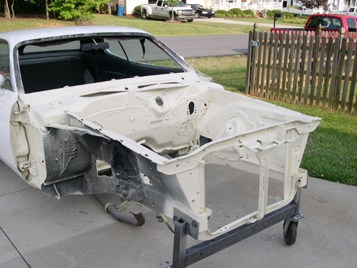

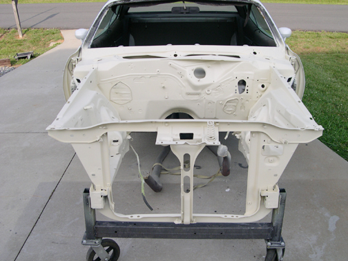

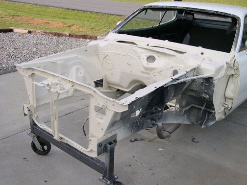

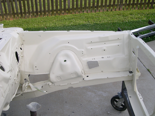

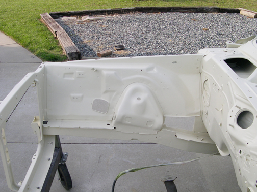

More progress! No, this isn't paint in body color, it's epoxy primer! Still have plenty of sanding to do--especially around the master cylinder area where brake fluid managed to rust the metal. Also need to use some filler on the areas where I welded patches in and rework those areas... but PAINT isn't too far off! YeeHaw!

Hey Bruce, I noticed that your ds inner fender has the bump in it for the 72 and up battery hold down. Is your car a late or early 71. The earlier 71 cars don't have it or did you change the inner fender?
