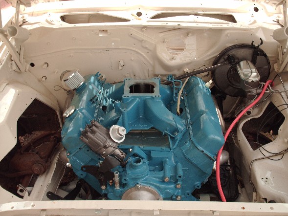

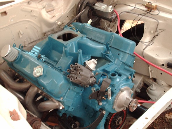

the car is mainly for the dragstrip, but will see some strip time.
440 specs:
11.75 to 1, zero deck .040 in the hole
forged crank w/windage tray
516 2.14/1.81 gasket matched, mild port heads
292/.509 purple camshaft
8 quart oil pan w/HV oil pump
Mopar M1 single plane intake
900 CFM Holley
Chrome ECU and MSD coil, 8.8 Accel wires
Stock distributor
Hooker 1 7/8" ceramic coated supercomp headers
internally balanced; line honed, cylinders bored, honed and torque honed; engine decked
727 Trans:
PTC 3800-4000 stall
4.2 lever, hemi governor, 12 spring front clutch, 4 gear front and rear planetary, b & m U JOINT breaking shift kit (ask me and I will tell you why hehe), alto clutches and bands
Rear diff/susp:
3.91 suregrip, 742 case
HD Springs
Rear swaybar
Pinion snubber
28 x 10.5 slicks

Lookin' Good Under The Hood!!!!
